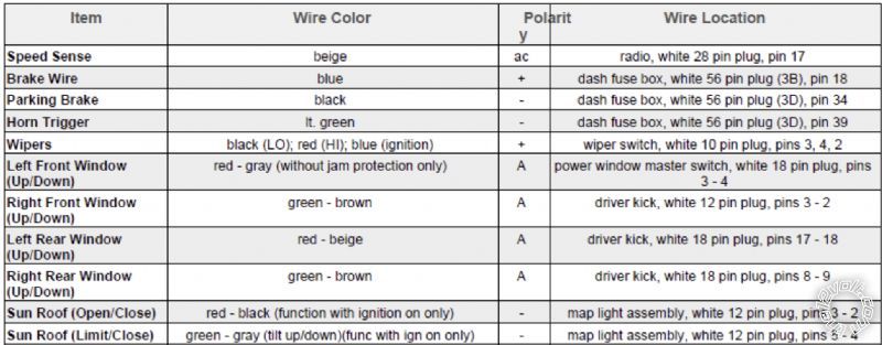

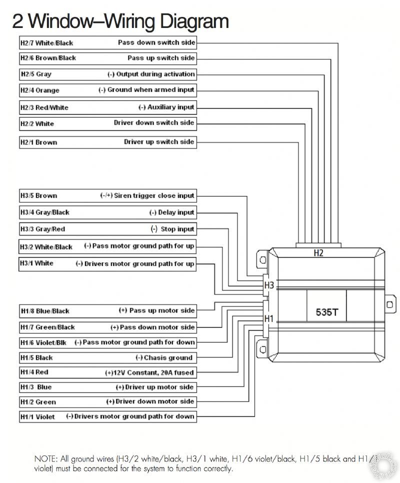

Wish to use a 535T window module in a 15' Toyota Rav4 for sunroof control. I already installed a R/S on the vehicle but have never messed with a window module. Using an Fortin Evo-One paired with their RF kit.
I would appreciate a guide on what wires to hook up where. I found the window/sunroof wiring online. I don't wish to have the 535T close the moonroof whenever I Arm the vehicle and I believe the Evo-One has only 1 Aux output which sucks.
