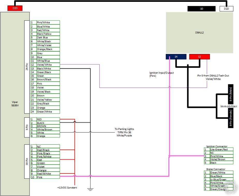

Afternoon,
I put together a crude diagram for the Viper 5806V + dball2 with Immobilizer Harness for a 2009 Jeep Liberty Limited Edition.
I am stuck on trying to figure out where all of the 10-Pin connectors go? I am also not sure if I need to even connect the 10-Pin (10 Pink) wire to the Ignition switch since it is connected to the dball2 ignotion?

Posted: January 02, 2017 at 5:09 PM / IP Logged Link to Post Post Reply Quote smokeman1
It states on the diagram, Black 10 Pin connector, Do Not Connect

Posted: January 02, 2017 at 5:37 PM / IP Logged Link to Post Post Reply Quote chrisjcline
My mistake for not being clear. I was referring to the 10-Pin coming from the Viper.

Posted: January 02, 2017 at 7:27 PM / IP Logged Link to Post Post Reply Quote smokeman1
Looking at the diagram, it looks like the only wires from the Heavy Gauge harness will be the Pink Ignition to the DBALL and Red to 12 volt constant.
