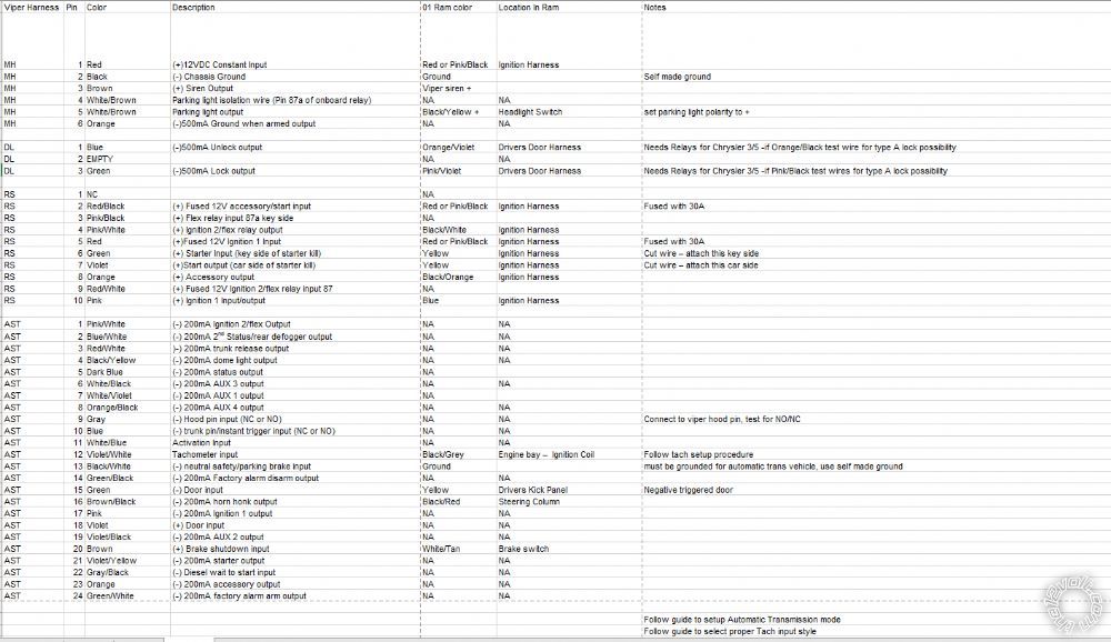

Could someone look this over and make sure everything is proper? I've done my best and spend quite a number of hours searching any information I could get to try and put this together, so that the install is as smooth as possible.
I'm going to be putting the Viper 5806V into my 2001 Dodge Ram 1500 Sport 5.9 V8. The truck is a Standard 2-Door, came with a factory keyless (I dont have remotes), but build sheet does not indicate a factory alarm system.

Attached should be a .png of the wiring list for the system. Please let me know if it is proper, and if not what to fix.
2001 Ram Sport - Viper 5806V -- posted image.

5 wire positive setup for unlock, straight positive output for lock. Two relays needed. Very unique door lock setup.

For the door locks, get a Directed 451M Door Lock Module. The vehicle Unlock goes open to unlock while the vehicle Lock
wire needs a (+) signal to lock.
RS 9 RED / White goes to +12V constant.
Everything else looks OK.
