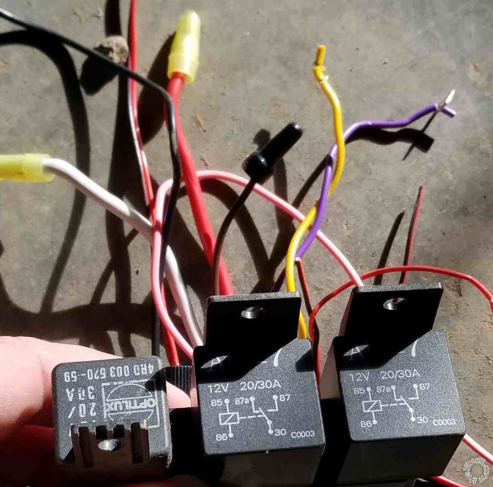

Well took the truck to my guy that has been working on these stuff for years and the12volt you were right.. It is a series of relays. See picture attached. Very simple yet effective for sure. can be hooked up to ANY switch and the light was just hooked in, in such a way that it blinked when the car was off and turned off when the car was running.. I figure the problem was with a relay going bad.. This sucker was hidden really well too. Anyone else ever seen this.. It's a DISABLER for sure.
Keep in mind with this setup I had to : Turn on the key, Hold down the DOOR LOCK switch and then turn the key to start to make the car start. IF you did this wrong.. the HORN would blow.
