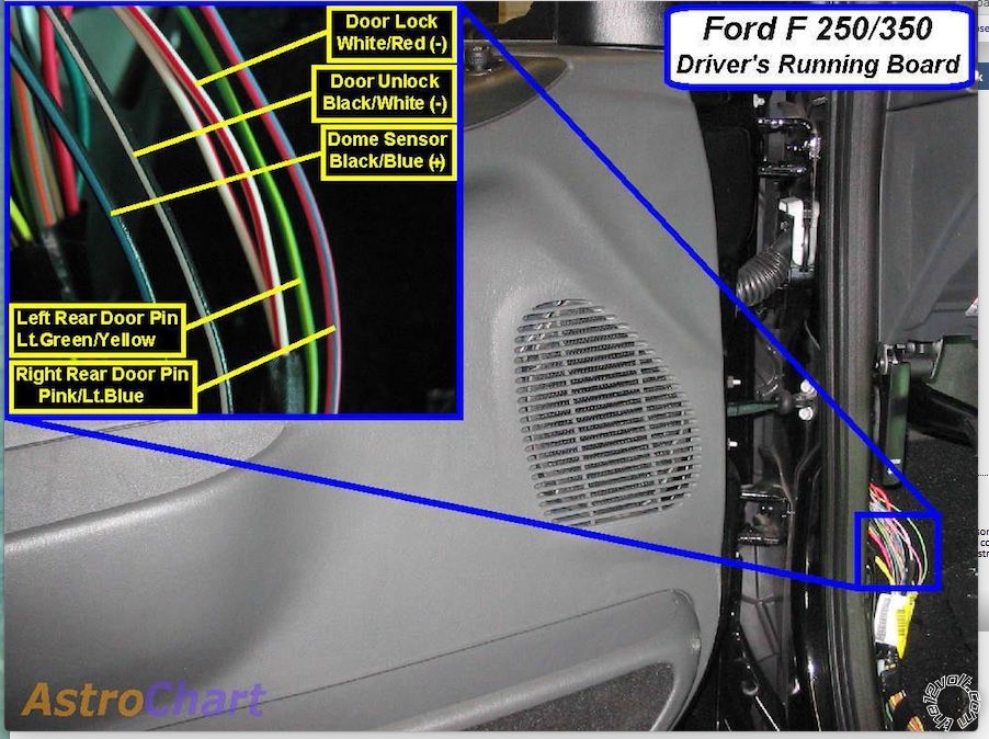

Posted: January 23, 2017 at 12:29 AM / IP Logged Link to Post Post Reply Quote bogucki
here are some pics for you that i have
2007 ford super duty remote start, door locks -- posted image.

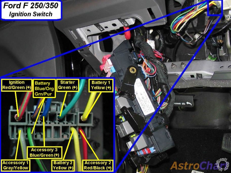

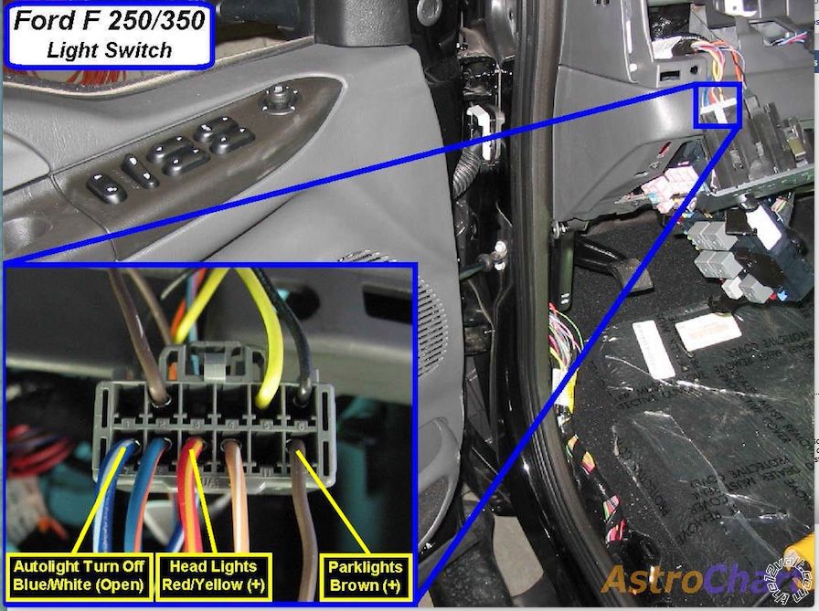

Posted: January 23, 2017 at 12:31 AM / IP Logged Link to Post Post Reply Quote bogucki

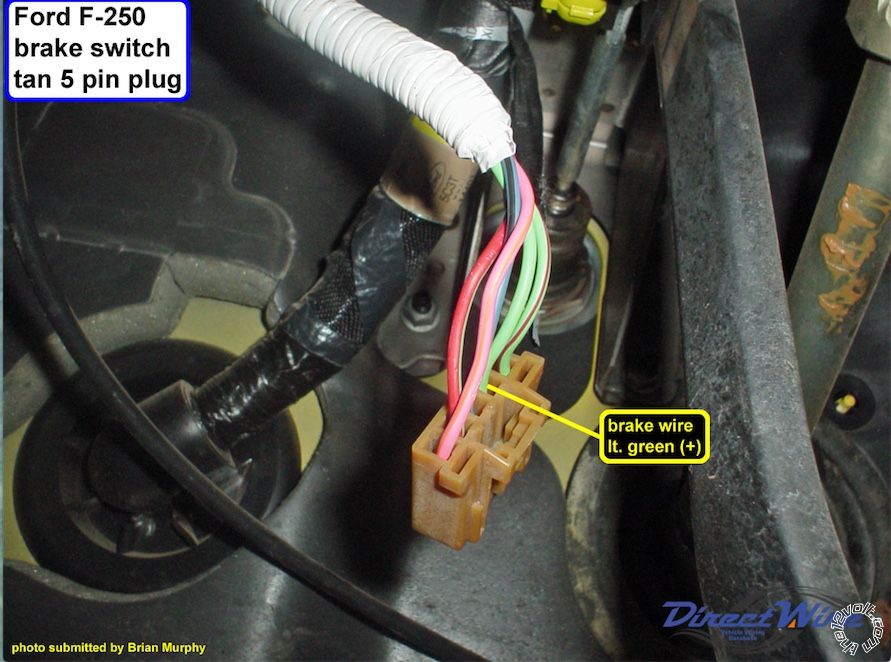

Posted: January 23, 2017 at 12:36 AM / IP Logged Link to Post Post Reply Quote bogucki
at the brake pedal switch

Posted: January 23, 2017 at 12:43 AM / IP Logged Link to Post Post Reply Quote bogucki
you will need to use relays to power up the 2nd and 3rd acc wires too, for the bypass your truck uses a 4 pin! connector at the ign switch not a 6 pin!,
