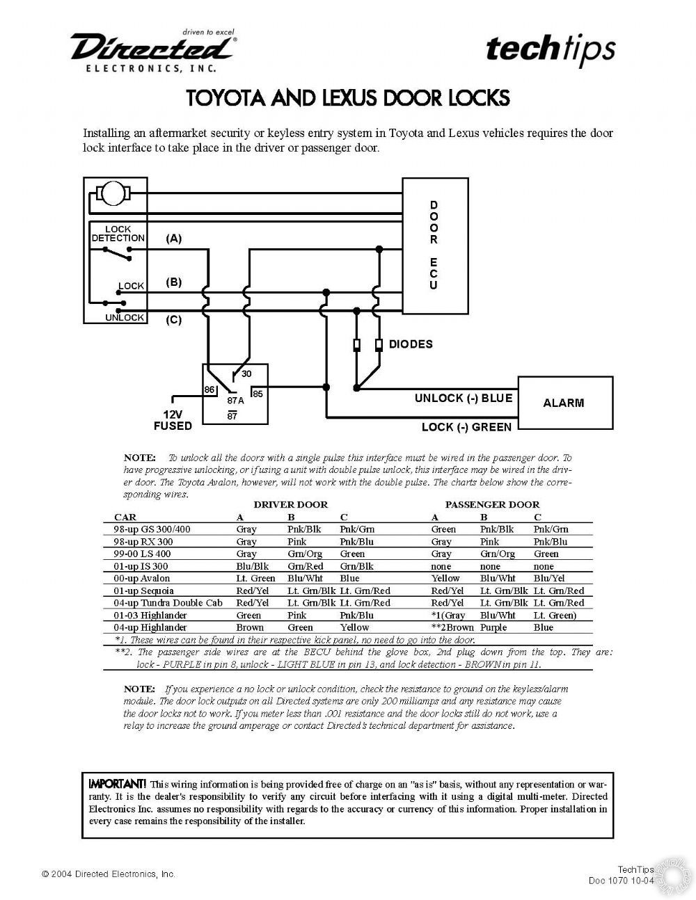

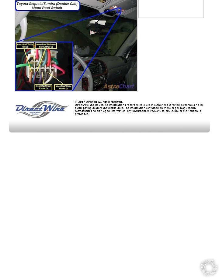

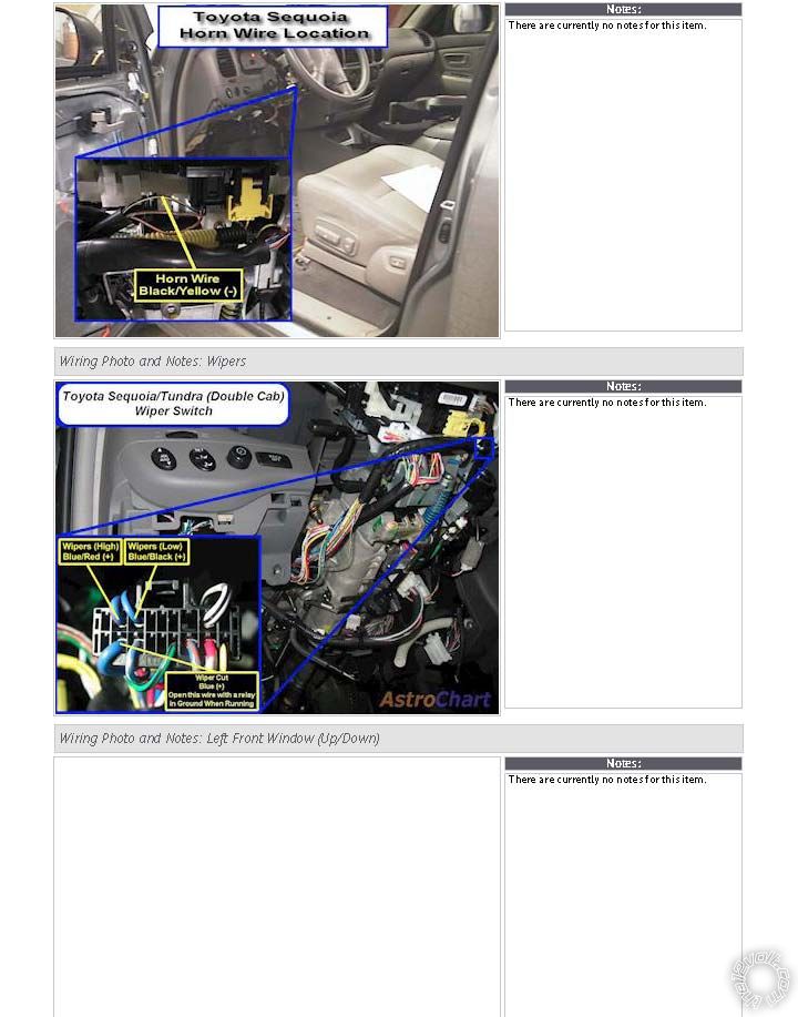

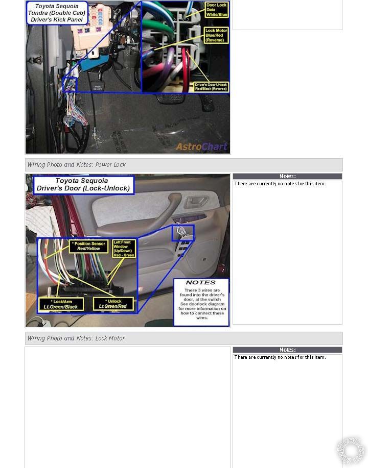

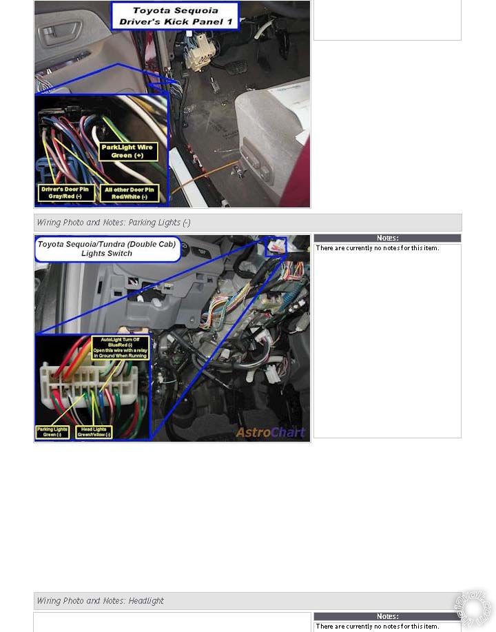

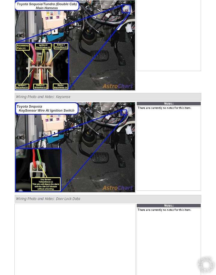

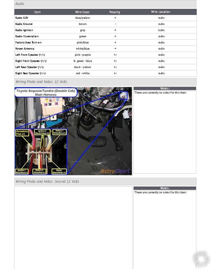

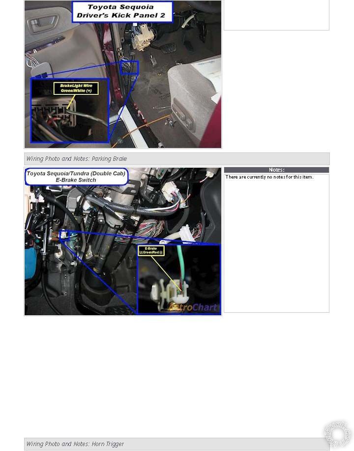

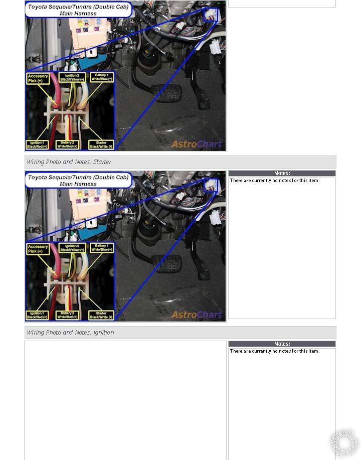

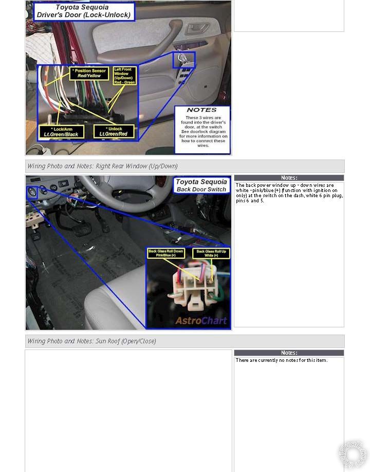

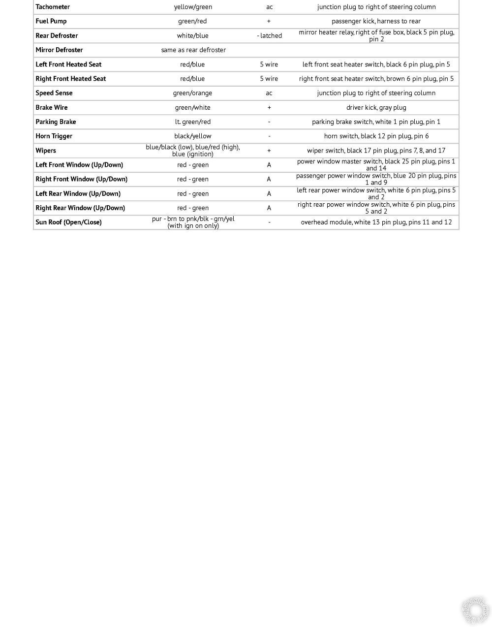

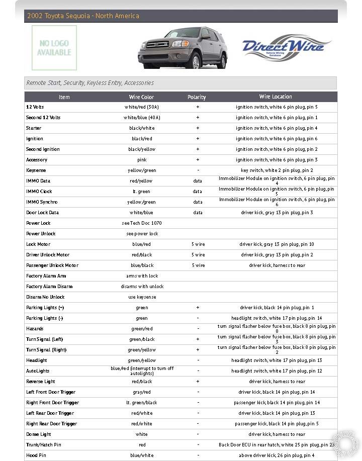

I have purchased a viper 5706v remote start system with an idata link immobilizer to install in a 2002 toyota sequoia. I'm looking for a wirring diagram for this install. I tried direct tech but as I am not a authorized installer/dealer they will not release the diagram to me. Does anyone on here have this diagram or any ideas on where I can get it.
Platinum - Posts: 7,827
Posted: January 22, 2017 at 7:06 PM / IP Logged Link to Post Post Reply Quote kreg357
http://diagrams.marktoonen.nl/printlist.aspx?MakeID=2&ModelID=15729
That will get you started....

Posted: January 23, 2017 at 1:22 AM / IP Logged Link to Post Post Reply Quote bogucki
02 toyota sequoia remote start -- posted image.

Posted: January 23, 2017 at 1:25 AM / IP Logged Link to Post Post Reply Quote bogucki

Posted: January 23, 2017 at 5:43 PM / IP Logged Link to Post Post Reply Quote snowboard60
thank you guys for the responses exactly what I was looking for.
