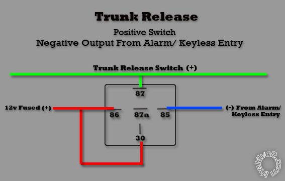

I'm installing the viper 4105v model on a 2000 legacy gt limited Auto. I have located all the wires I need based of the wiring info found on this site. The wire color and locations I'm looking for are (-)200mA horn output, (-) parking brake input, and (-)200mA rear defroster output. Will I need any relays for those mentioned connections? Also I'm installing a DEI 522t trunk release kit to the remote starter. I have a relay that I plan to wire like the picture. If any relas are need for any part of the installation please provide correct wiring info. Thanks in advance for the help.
2000 legacy viper remote starter -- posted image.
