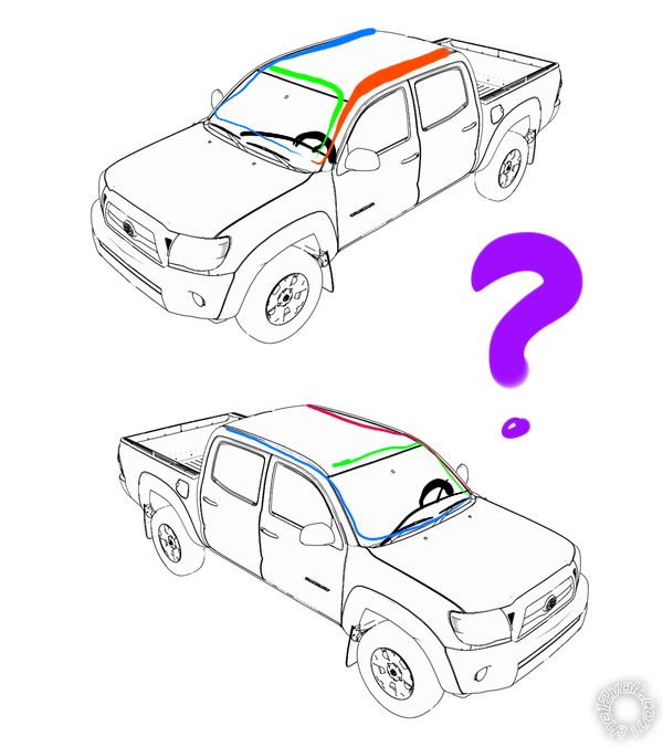

First question: The easyguard seems to have 4 proximity antennas (long/longish wires with a 3" skinny black box at the end with adhesive). The installation instructions have an obscure diagram of where to run them. The question is where to route these wires/antennas in a Tacoma Double Cab? The illustration is included is my guess, feel free to draw something or explain or just say (X & Y colors).
2010 Tacoma Proximity Push Button Install -- posted image.
Thanks!

I would leave the placement of the antennas for the last step of the install. Do everything else then experiment with placement to see if it picks up the remote from where you need it to.

The antennas were supposed to be installed in a "T", so I put one on the passenger side of the mirror horizontally at the edge, the other at the driver rear window vertically. Remains to be seen how they work.

as far as routing the antennas, does it need to be outside the truck? i guess it says thats where they should go but i would see how it works if you leave it inside because running wires outside of a car can be a little tricky sometimes if you want them completely hidden. if the have to go outside then run them outside seam where the fenders meet the A pillar, then up the sides of the windshield gasket, youll need a plastic pry bar so you dont scratch the paint, then if you need to go all the way to the back you can run the wires under the roof trim that covers the seam between body and roof. its hard to say exactly how this piece comes off because theres so many different ways that they can be attached so if you can just pry it up enough to get the wire down in there that would be best. if you do have to remove it completely then dont bend it because youll never get it to look right again after you do.
