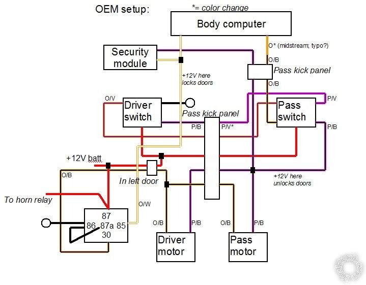

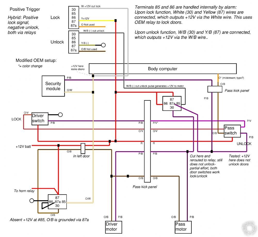

I have a 1991 Dodge Daytona base model with factory power locks. The car has a cheap "Spy" alarm/keyless entry/remote start. Reading the wiring diagrams for it, there are two onboard relays for door lock and unlock.
It will remote lock the doors OK but will not unlock them- it tries to do so but it's like there is not enough effort. The inside switches do both OK, although the driver switch was hit or miss. I took it apart and used some 1200 grit sandpaper on the contacts and it is 100% now.
I have attached two diagrams- the OEM setup and what is there now. The car is unusual in that it has only 1 OEM relay- the car will lock the doors once you hit 15 MPH. It has no unlock relay since there was no OEM keyless system installed.
My hybrid wiring is a calculated guess using the relay diagrams here. Using the vehicle database here, I did not find the mentioned wires at the driver kick panel, but did find them behind the body computer on the passenger kick panel. I made use of the OEM wire from the body computer and tapped into it for remote locking. I cut the P/B wire prior to the connector and checked the ends, connecting the switch side to 87a and the motor side to 30.

hare you tried interfacing the switch directly?

Do you mean running +12V to the P/B wire from the passenger side switch? If so, yes. It would not unlock both doors, the same partial effort happens. When I disconnected the connector by the kick panel it would unlock the driver side only.
I'm presuming the relay has enough juice to perform the job, it's fed by a 16 G wire that is tapped into the lock power feed.

I had cut the passenger P/B wire after the splice to the passenger motor. Once I ran 2x wires into the door and cut the P/B wire near the switch (before the motor) this resolved the problem.
