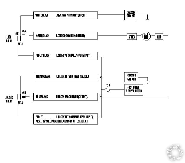

Posted: March 23, 2017 at 7:26 AM / IP Logged Link to Post Post Reply Quote kreg357
Your wiring looks correct. You should be following the Type D diagram from the 451M install guide shown below.
Viper 350 responder and 451m -- posted image.
Did the door lock solenoids come as a kit with a controller and harnesses or just the individual solenoids with hardware?
If it was the later and you are directly connecting the 451M Green/Black and Blue/Black to the solenoid wires, here is a test
you could do to see if the 451M is wired and working correctly. Cut the 3 wire Red, Green, Blue harness in the middle. Connect
the Red to +12V. Briefly touch the Green wire to Chassis Ground. The lock should lock. Next touch the Blue wire to Chassis
Ground. The lock should unlock. If that works, there is something wrong with the Vipers lock outputs.
