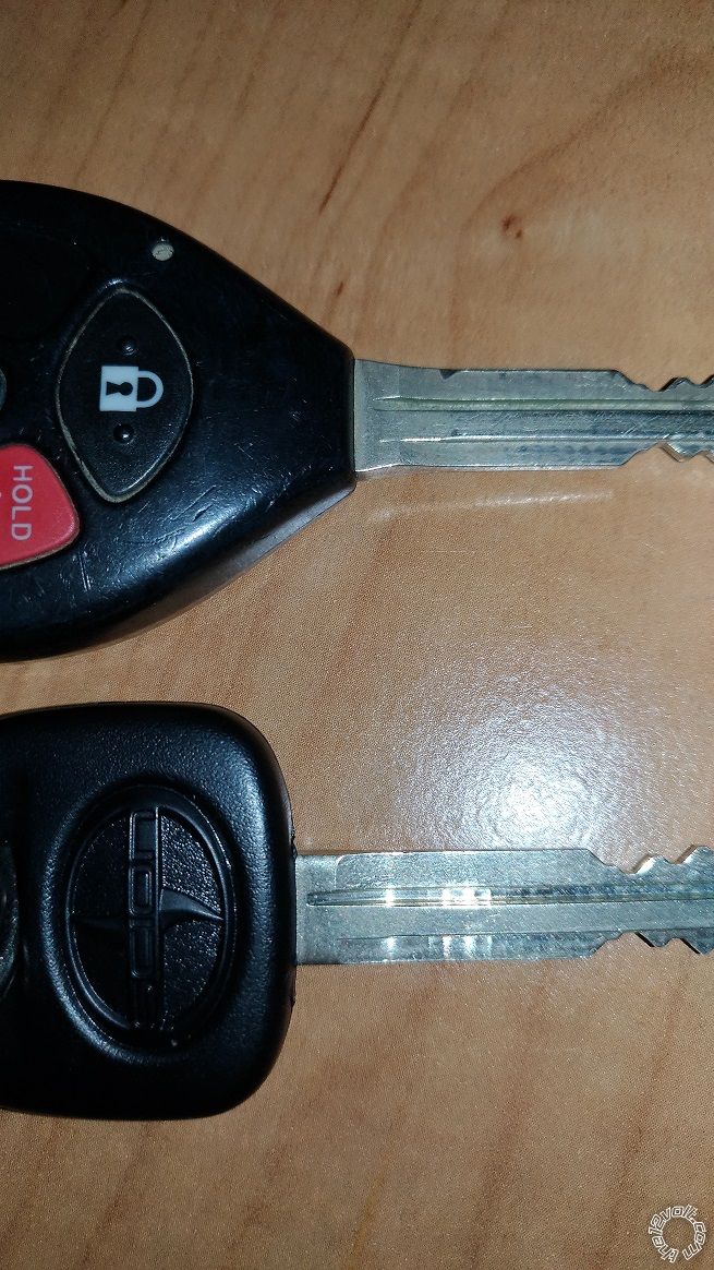

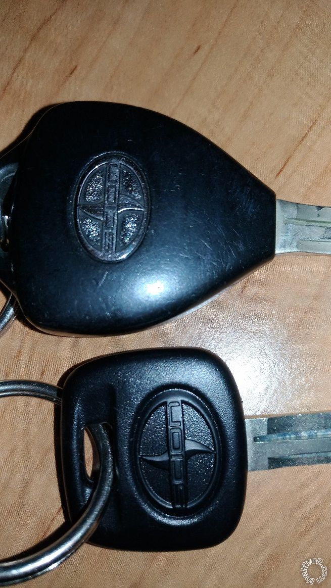

kreg357 thanks for the suggestions. The more I look at the Keys the more I'm incline to think they don't have a chip in it. I can't find either a "G" or "O" on both the keys.

Platinum - Posts: 7,828
Posted: March 30, 2017 at 7:50 PM / IP Logged Link to Post Post Reply Quote kreg357
Try the Foil Wrap test.
Just wrap about 5 layers of aluminum foil around the black plastic key head and try a regular key start.
Posted: March 30, 2017 at 11:55 PM / IP Logged Link to Post Post Reply Quote kreg357
Another way is to just key a plain key cut for $1.99 and see if it will start and run the car. They might have the blank at ACE.

Posted: March 31, 2017 at 3:48 PM / IP Logged Link to Post Post Reply Quote fastsec
Went to ACE hardware and had them check my key on a machine that can tell if there's a chip in it or not, and turns out the key doesn't have a chip. Just for safe measures had them cut me a regular key to test out, which did work when I tested it. I'll be taking out the FLCAN and just'll be finishing up the wires on the Prestige APS997E. Thanks for ur help kreg357.
