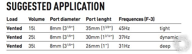

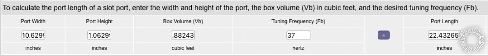

I came across a good deal on a pair of Focal P25 subs (loose, not in the Focal cabinet) so I scooped them up to put in my work truck. Nothing special, but I like good clean loud music. So I am building a custom cabinet for them and I noticed that the port length recommendations are really short - like 1" - 1.375". I tried to validate this using the calculator here using their box volumes and it says ~15" long. Something is not adding up.
Any thoughts?

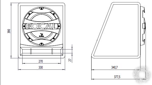

Additionally I researched the cabinet that this sub came with as a kit and it uses a slot port, that on face value doesn't make sense either...

the tuned frequencies that they show are the overall peak frequency of the sub and box,(f3) your box calculators are giving you just the peak frequency of the box itself(fb). thats why its not adding up

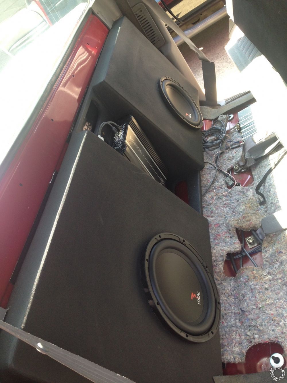

So, as a follow up, I went a ahead and built a box based loosely on the lower end recommendations. Finished up the install yesterday and played around briefly for initial tuning. So far it sounds pretty impressive in the low end, but definitely needs some more tuning.
System details-
Alpine CDA-117
Eclipse 3640
Morel Maximo 6 comps
Orion XTR 600.4
Focal P25's
It's a work truck, this was about all I was willing to do for it.

Shortened the port length today by 3", lost the heavy resonance at 30ish hz gained punchy hard hitting 50-60hz like crazy.
Foreigner, Eagles, White stripes all sound convincing now. Kinda miss those low hits for Thievery corp, Aphex Twins etc. Will work some more on port length next week, for now super satisfied.

To answer your ?'s - internal box volume is - 1.137 sq ft - Slightly less than the 35l recommended (32.20) - plus about a pound of polyfill per sub. The ports were sold as 4.5" x 3".
Originally, I actually kept the port as purchased (4.5") just because I knew that the id was an 1/8" smaller than the spec (3 1/8") and because I knew that I would run into some in resonance. Still, the port shortened to 1.25" seems to offer the best SQ with zero signal conditioning. That leaves me with plenty of wiggle room for equalizing and such.
