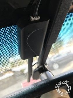

Hi Guys,
New to the forum and I need help please. I recently purchased a used 2009 Toyota Sienna van for my daughter. Nothing was said at the dealer about it having a remote starter and no remote came with the car. I happened to noticed an antenna attached to the windshield that looks like the antenna for a remote starter. I've tried to attach a photo of the antenna.    Does my car have a remote starter? - Last Post -- posted image.
Can anyone confirm for me that this is a remote starter antenna? And if so, how do I go about identifying the brand and model and is it possible to buy a remote control for it?
Please let me know what additional information you may need.
Thank you
JoeFixes
Platinum - Posts: 7,827
Posted: April 02, 2017 at 5:38 PM / IP Logged Link to Post Post Reply Quote kreg357
Looks like a Compustar AM one way antenna. Follow the wire harness back under the dash to locate the control unit. If it was installed way back in 2009 or 2010 it might be a CM4200. You could take a chance and purchase a used but working remote off EBay for $15 like the 1WAMR models and see if it works. Programming a remote is easy - just cycle the ignition key from OFF to ON 5 times in 7 seconds and then press the Lock button on the remote.

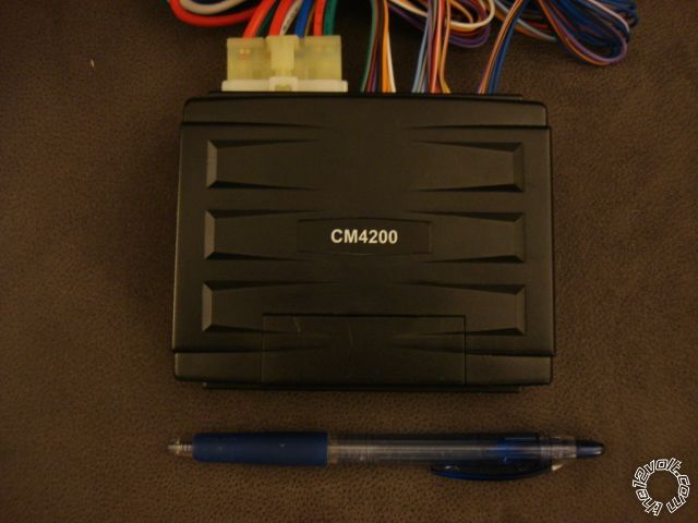

Posted: April 02, 2017 at 7:07 PM / IP Logged Link to Post Post Reply Quote kreg357
Something like this :

Posted: April 03, 2017 at 12:32 AM / IP Logged Link to Post Post Reply Quote silvercivicsir
the antenna plug looks wrong.. I have only ever seen "blue" 4 pin antenna plugs for a compustar.. could it a be knock off?
Try turning the ign on/off 5 times to see if the park lights flash
