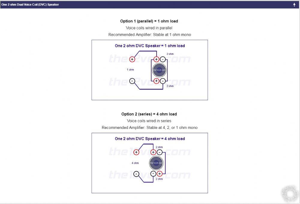

is it possible to wire a duel 2ohm voice coil sub to run a 2ohm load using both voice coils with a monoblock amp?

No, the only options for a single sub are limited. A dual four is 8ohm and 2ohm stable, as a dual two is 4ohm and 1ohm stable. Although if you add another dual 2 woofer then yes. You can run it at 2ohms because you are no longer limited on your load options. 2 ohm loads -- posted image.

thank you that's what i thought but just wanted to make sure before i sell the sub! Its sauch a good deal i couldnt pass it up but didnt think realize it was a duel 2 ohm until i stared to hook it up. my amp is 2ohm stable, maybe it just squirerel it away fore a future build lol thanks again
