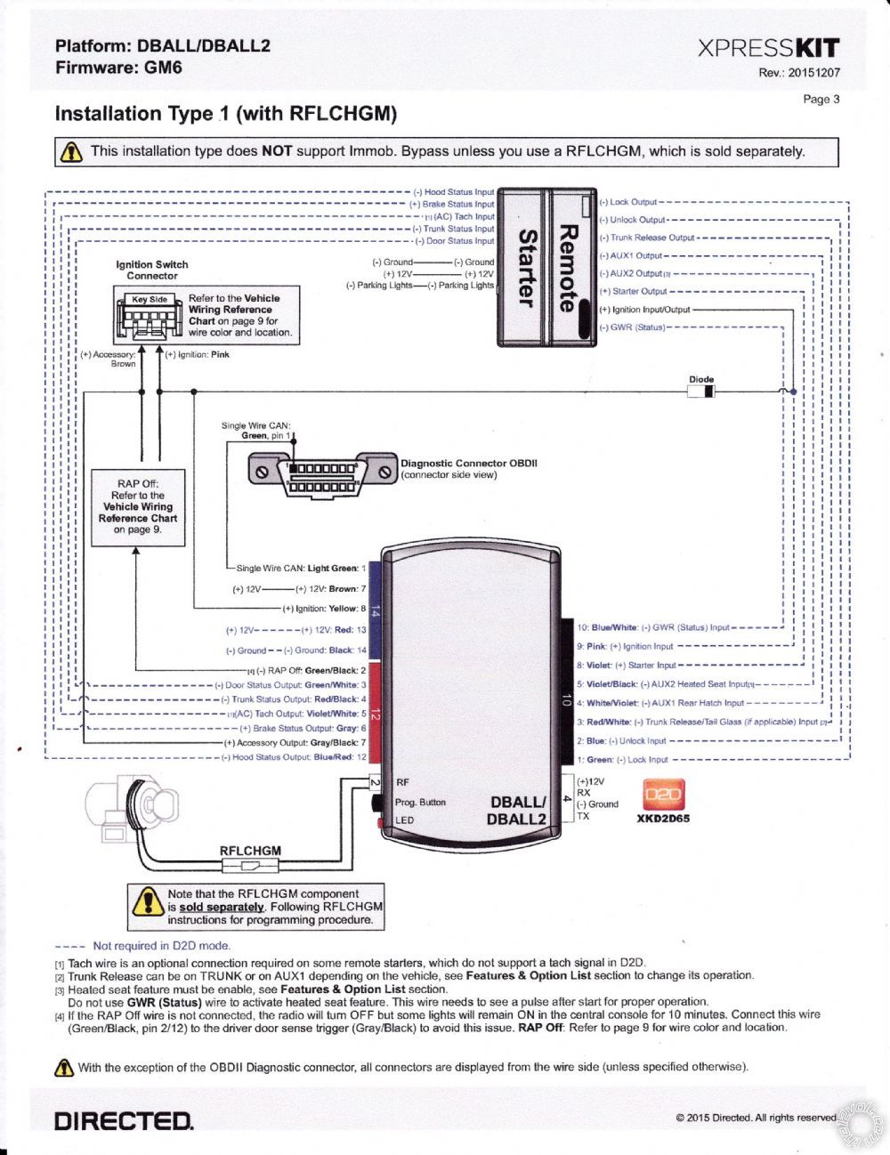

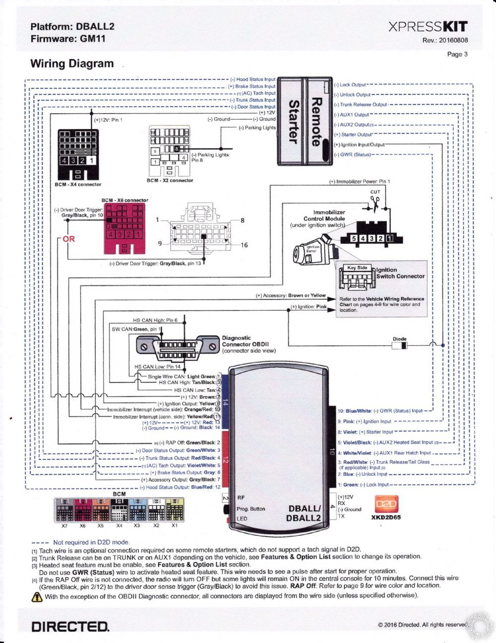

I did reprogram the bypass with the latest firmware and no change.
Older firmware was GM6. the latest is GM11, both of these are wired differently according to the installation guide.
Is there a way to go back to GM6 firmware or I'm stuck with GM11?
Thanks.
Thanks.

Did you run into this problem before or after updating the firmware? I think you can go back to the GM6 but I'm not 100% sure...

sgarcia1212 wrote:
The issue started before updating firmware.
I would either wire the RS according to the new firmware or try and downgrade the FW. It's going to be hard to figure out what is going on until that is done.

Do you know how can I downgrade the firmware?
