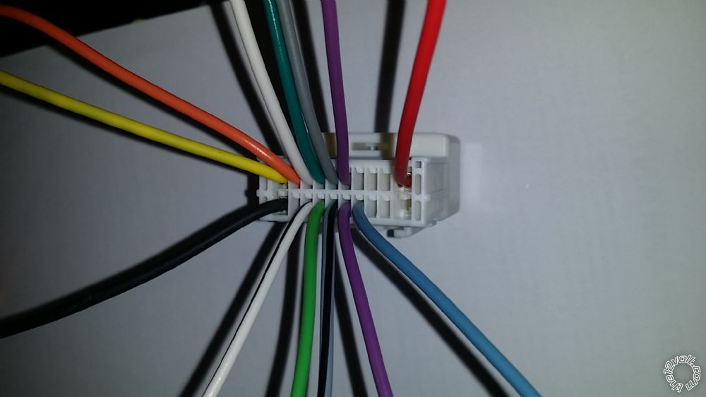

I have 2017 Mitsubishi Outlander with Android auto and Apple carplay.
Looking to put subwoofer in it so will need the stereo wiring diagram.
Thanks

Posted: May 14, 2017 at 6:43 PM / IP Logged Link to Post Post Reply Quote gagz
The unit is without amplifier, by any chance you have picture of the back of the stereo of the 16?

Posted: May 14, 2017 at 9:45 PM / IP Logged Link to Post Post Reply Quote i am an idiot
No picture but I think I have a harness at work and I will take a picture of it tomorrow.

Posted: May 15, 2017 at 12:30 PM / IP Logged Link to Post Post Reply Quote i am an idiot
2017 Mitsubishi Outlander stereo -- posted image.
This is a picture of the harness I would sell you to put an aftermarket deck in that vehicle. The plug of your vehicle would plug into this one. Find the ground wire on your harness and position accordingly. You can see the black stripe on a couple of the wires. All spkr negatives are on the row that you can see a couple.
