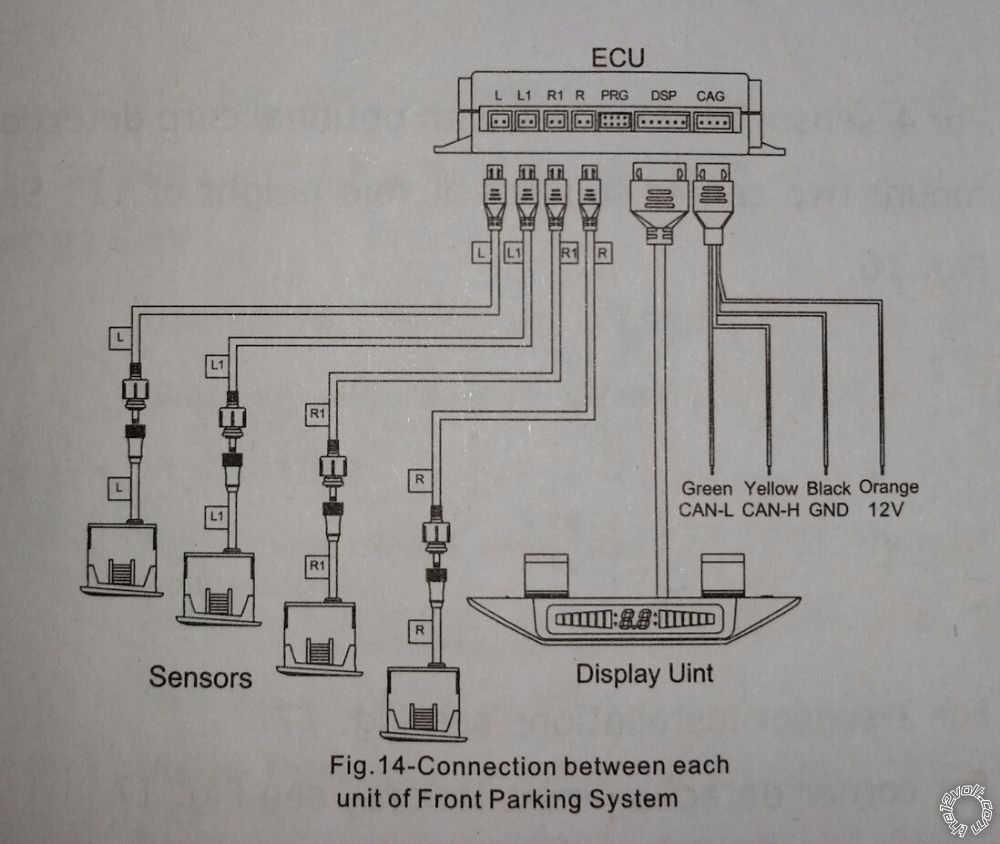

Thank you rs specialist for your response. I have verifed the location of the VSS wire. The front parking sensors are Rostra 250-1920-FZ. Attached is the wiring diagram from the installation manual. Looking forward to hearing from you soon. Thanks again! 2006 Toyota Camry CAN wires -- posted image.
