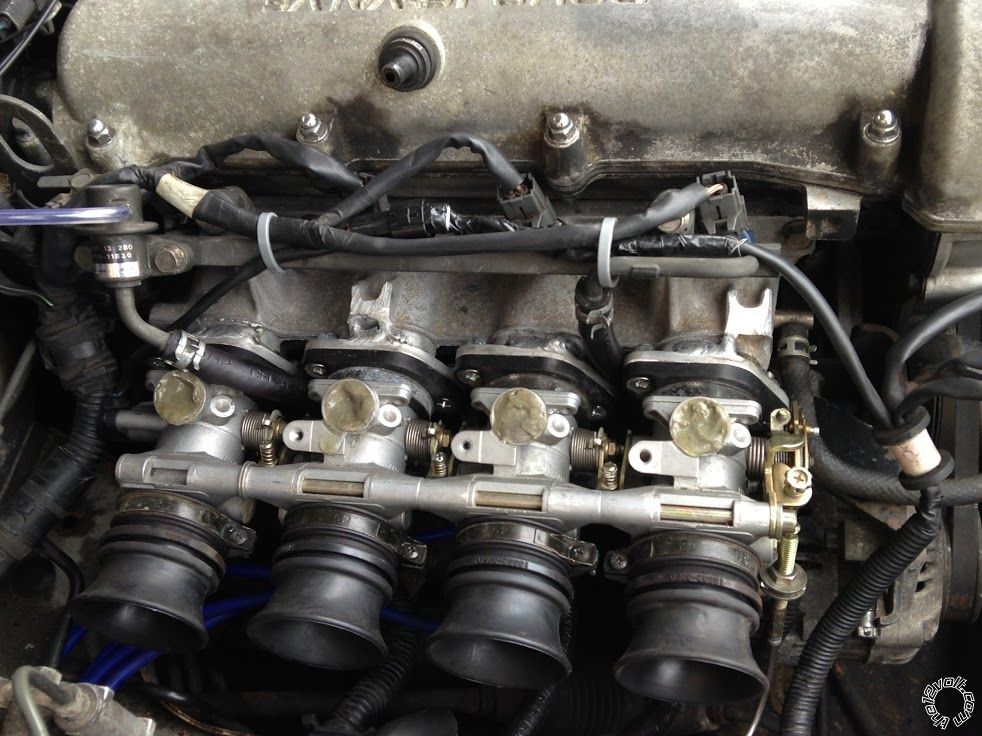

And. What i can do to deleted flow meter same car accent 96 to 99 im going to install individual trottles bodys and. How. I or what i need to do to removed the flowmeter..is something i can use to cheat the ecu?

Posted: May 31, 2017 at 12:37 AM / IP Logged Link to Post Post Reply Quote flaco7136
How to install a beer-r rev limiter on hyunday a -- posted image.
this is my idea for my hyundai so i need to some how deleted flowmeter n cheat the ecu any ideas? Ty

In regards do your mass air flow meter - you can't simply delete them or "trick" the ECU. This sensor is vital in controlling how much fuel is injected each revolution. If you tried to "trick" the ECU and were off by just a little it could cause major drivability issues and could cause permanent engine damage. Your ECU MUST know EXACTLY how much air is being drawing in to control the motor properly.
To go with four throttle bodies you would probably want to run (4) MAFs with a summing circuit that adds all the air flow together. You will then need a custom tune to calibrate how much fuel is being injected compared to the signals created by the (4) MAFs.

If i use the flowmeter that i hace just in 1 trottle bodie ..it can work or not posible? Is. Not. Going to give me. A good reading right? Un doing this my self no one want to help me. N i don't have to much money but a like the way they sound thats why i want to do it.. Ty
