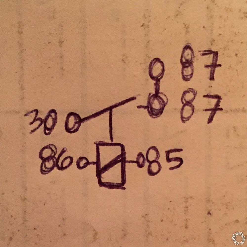

On the initial attempt, everything worked beautifully and I was able to sound both the musical and standard horns. Here is how I had it wired:
However, this also caused to compressor to get extremely hot and begin smoking. I immediately unhooked everything and decided to do some research on the wiring and relay.

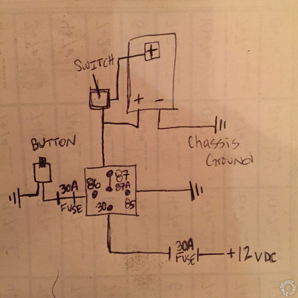

After learning all I could about relays and how they function, I attempted to wire it all back up using the new information I had learned. This is the diagram as listed on the relay:
Everything I have tried since my initial installation has resulted in nothing but blown fuses. I have searched and tried every different wiring option I found in the forums. All I did was blow more fuses. What am I doing wrong?!?!?
