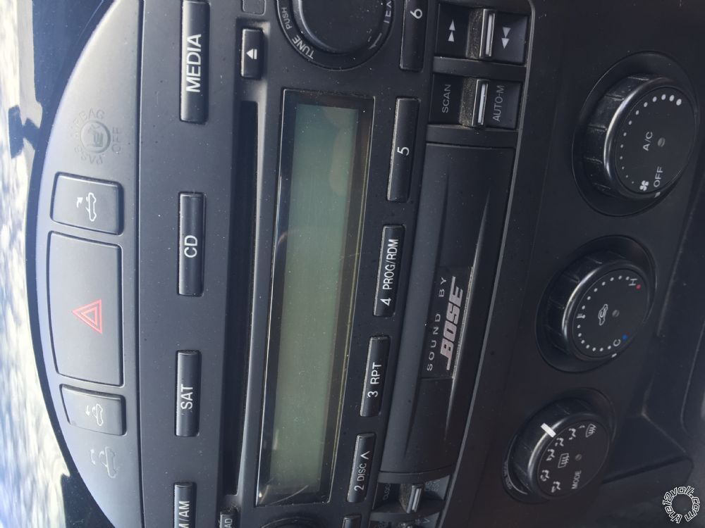

I have to install a radio on a 2008 mazda miata.
I noticed it SAYS bose system. I ordered the harness(70-7903), the radio kit(99-7506) and also a pioneer radio.
Im hoping someone can tell me if I have to bypass the Original amp to install an aftermarket radio?
if so, where is the original amp and where can I found the pin out diagram?
here is some pic
2008 mazda miata, aftermarket radio -- posted image.
