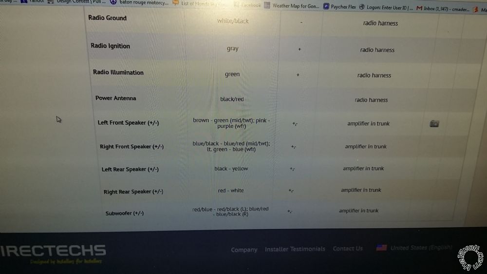

Would you happen to have a wiring print for the factory amp? I was hoping to grab all the speaker wires there to connect to a five channel im running and not have to run new wires to each speaker.

Posted: June 29, 2017 at 8:31 AM / IP Logged Link to Post Post Reply Quote i am an idiot
2002 Lexus SC430, Complete system replacement -- posted image.

You will need to install a capacitor on each of the tweeters if you are planning to use them. 4.7 6.8 or 10 microfarad non polarized at 100 volts.

Posted: July 02, 2017 at 8:06 PM / IP Logged Link to Post Post Reply Quote sparxx513
So i got the radio in, replaced the blown 6x9's in the door, blown sub, and blown 4 inch in the rear. Right now it is running just powered by the radio and using the beat soinc bypass. NAV still works on the factory screen. The sound is not the greatest though. I though i read somewhere else that the factory amp has to stay in to keep the nav working? Also if i were to replace the amp you think that would work running all three front speakers on one channel? Ro leave the factory amp on the mids and tweets and use the new amp on the remaining 5 speakers? Once again appreciate all your help.
