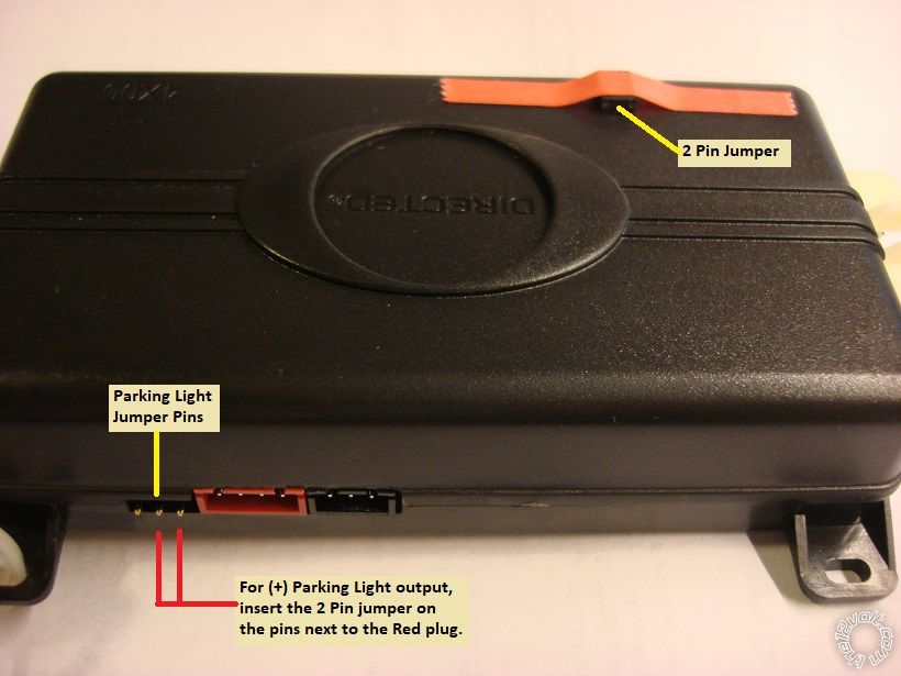

Where does the jumper for the parking lights go?

a picture is worth a thousand words.....
Detailed Viper 4115V instructions needed - Page 2 -- posted image.

Posted: November 01, 2017 at 8:13 PM / IP Logged Link to Post Post Reply Quote nadorp
That is Awesome!
Thanks for that pic.
