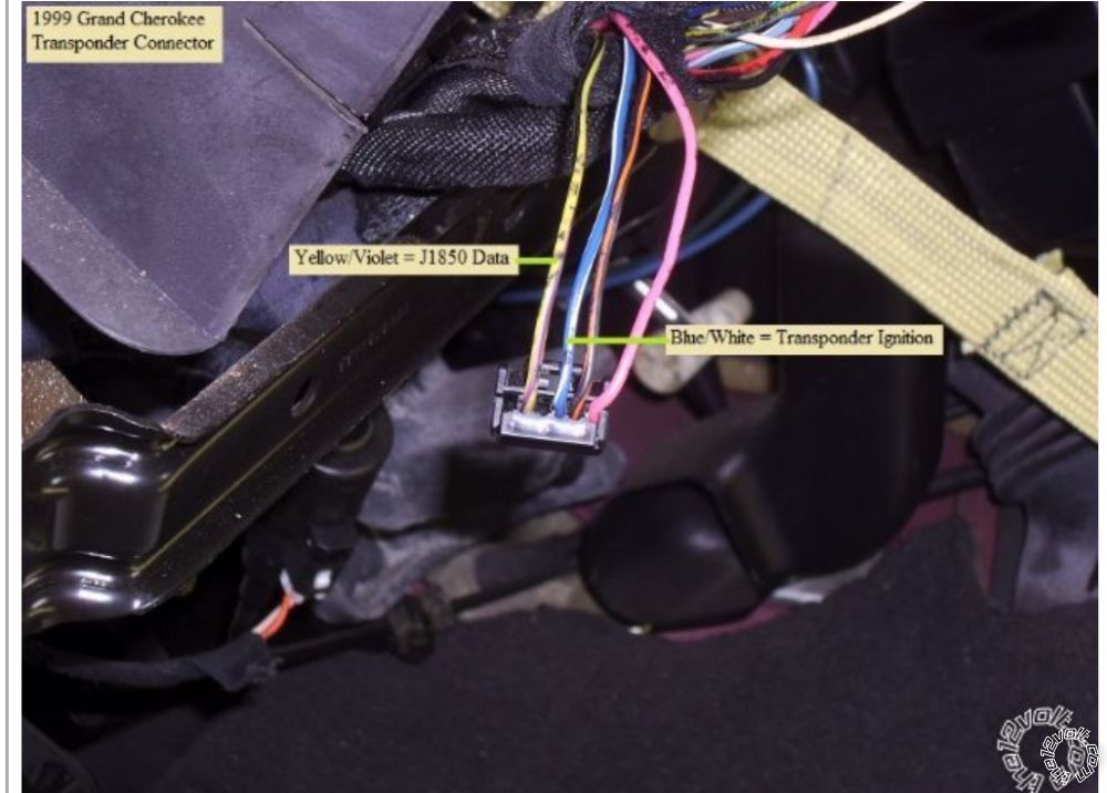

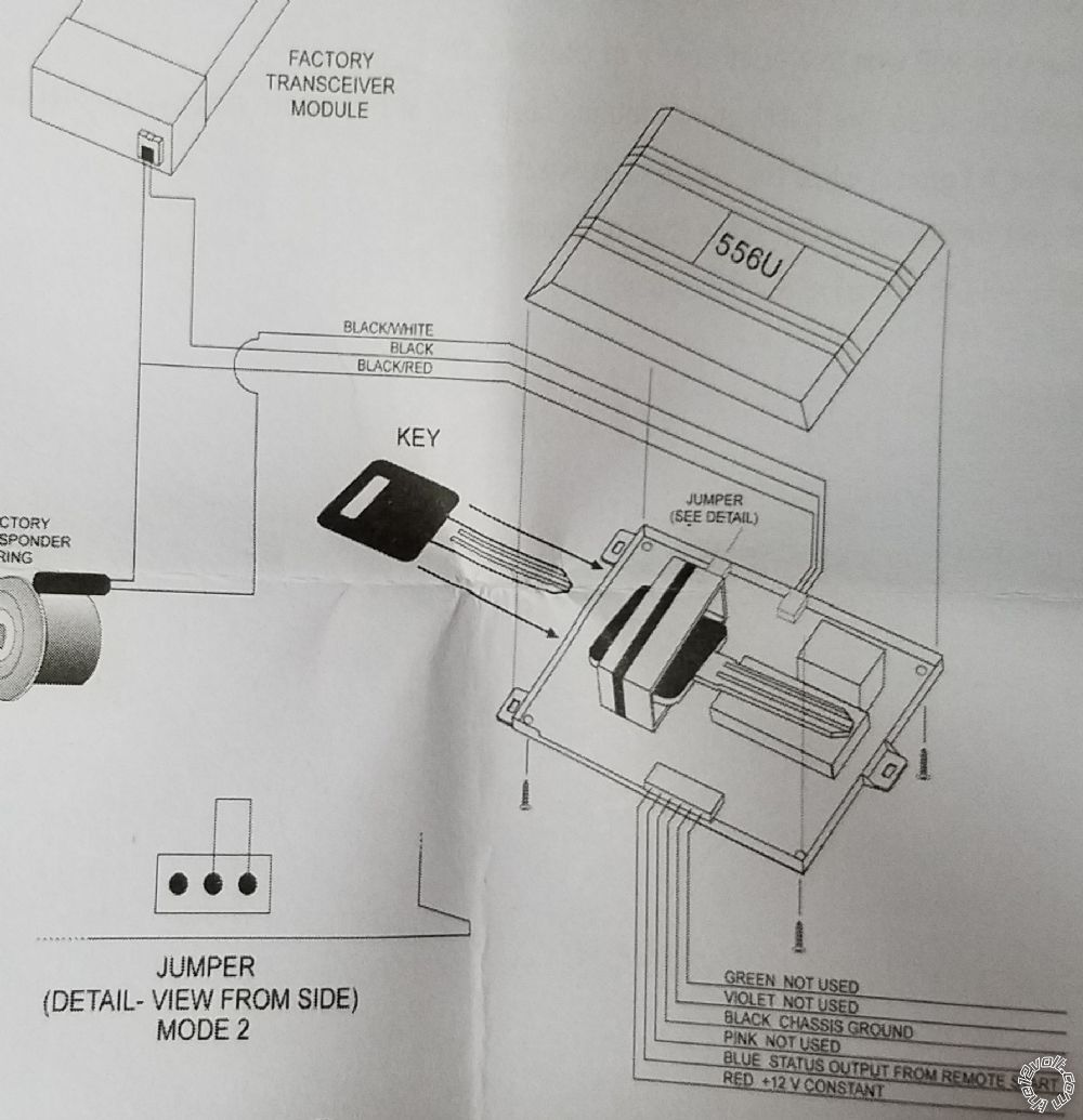

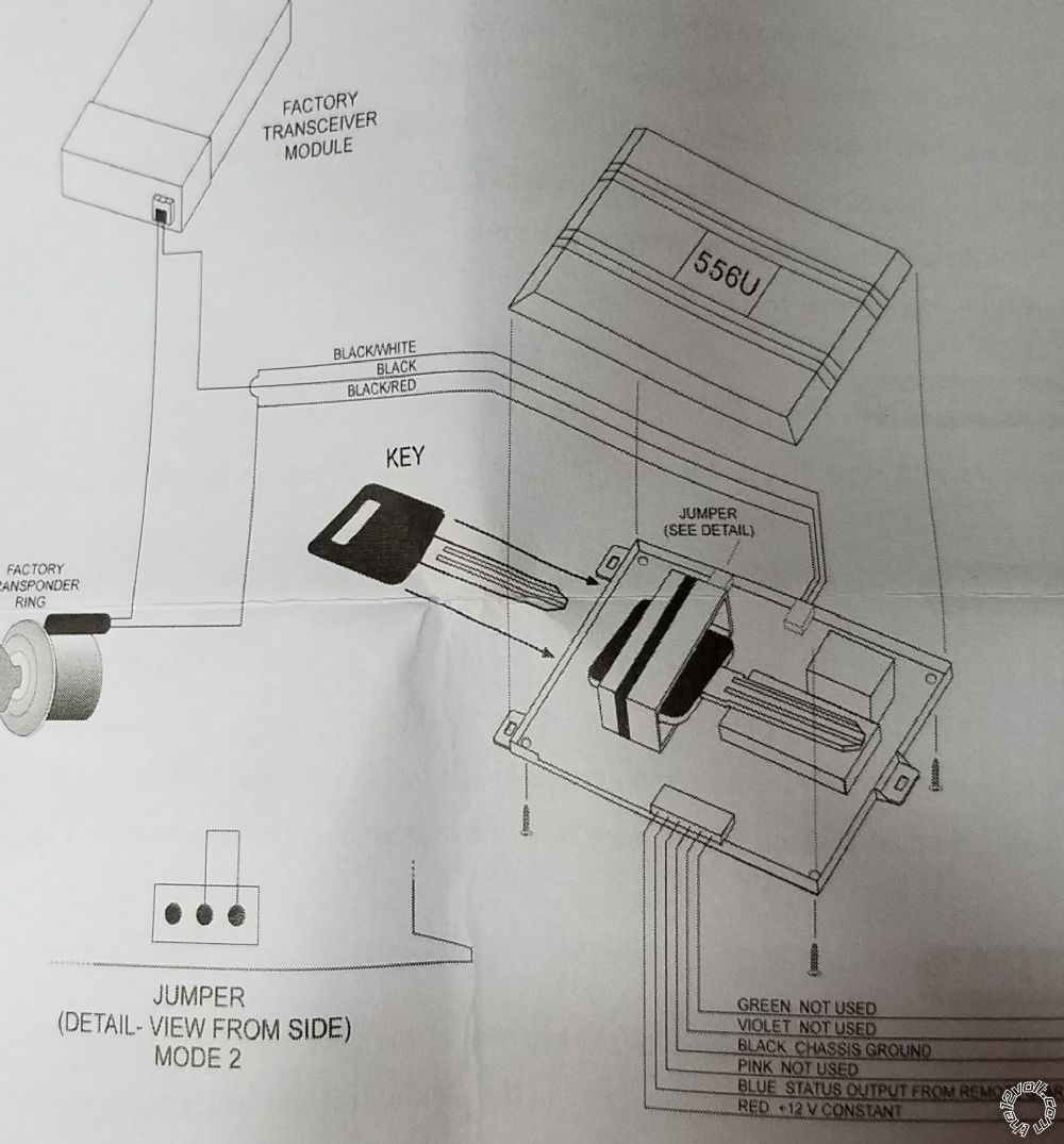

Hello everyone im new to this forum. I have a 2002 jeep grand cherokee, i have been reading alot of forums a threads on this subject. I just can not find the answer to it. Im trying to hardwire a dei 556uw interface to the sentry key immobiler. The truck has a nonworking aps996a alarm/remote start w/ a dei 455j lock interface and a dei 555c immobilizer interface. Im installing an aps 997e alarm/remote start w/ a dei 457cw lock inter and a dei 556uw immobilizer inter.Dei 556uw hardwire to sentry key immobilizer -- posted image.
This is using the antenna
This works on european vehicles
This works on non european vehicles

I got this on one of the threads.
I have read harding it is the best way. So my question would be what is the best way? And if i hardwire it which way is the best and which wires would i connect to the wires on the sentry wire harness.

Not a option on that truck. The factory transponder antenna wiring doesn't come out of the sentry module.
