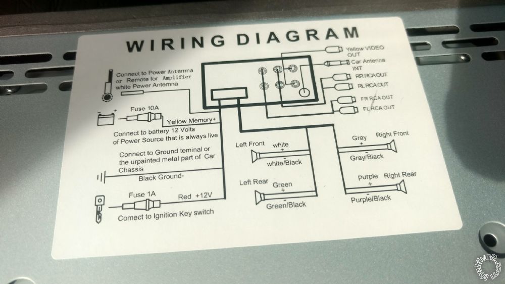

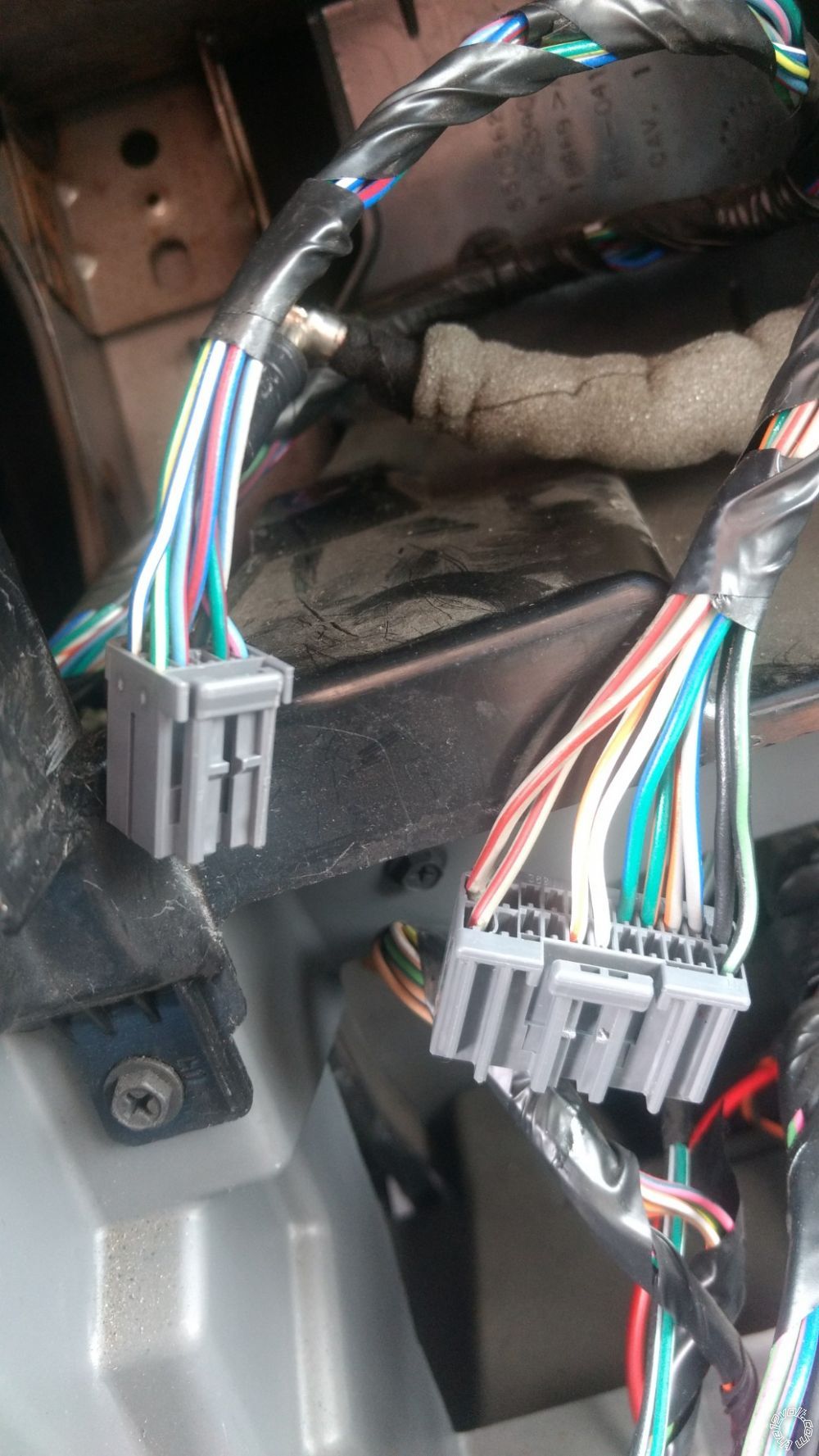

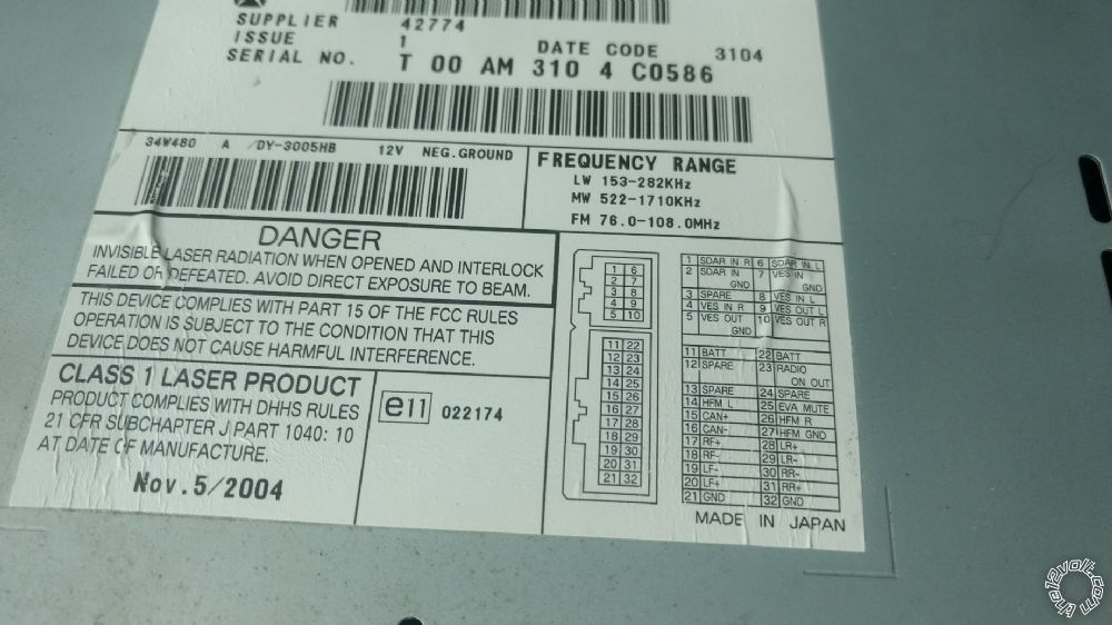

Having prolem with aftermarket Radio wiring in my Dodge Durango 2005. The car have infinity sound system. Can I connect the radio with out disable the amplifer ?

You can still utilize the amplifier. But it will require a special harness to turn the amplifier on. Pac-audio.com c2rchy4 or one of the Metra chto units. You will lose the fader with the pac harness. The metra harness will allow you to keep the fader. Go to metraonline.com and see which one your truck requires.
