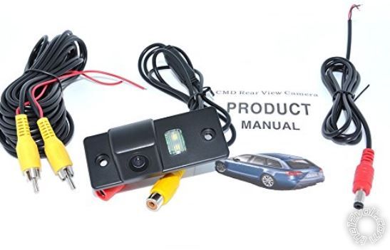

I installed a backup camera in the license plate light of my car. The camera looks like this:
The camera has a built 2-smd LED light separately powered from the camera. I used a relay because the reverse trigger is 6.5 volts and the camera is 12 volts. My car's daylight driving lights turn on the license plate lights so the LED should be always on when the car is on to match the second license plate light that is always on when the car is on. The camera should only be on when the car is in reverse.

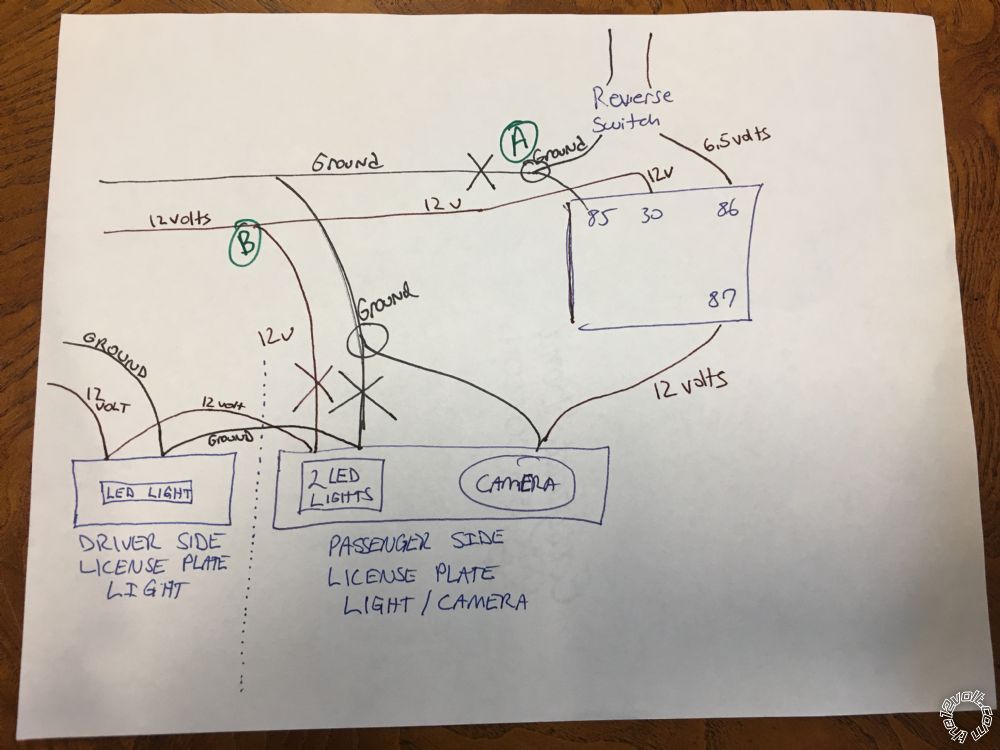

Here is the problem. The LED is not on all the time. The LED only turns on when the car is in reverse and the camera is on. So I know the LED works and the camera works. I would like the LED to be on all the time. I think I messed up in connecting too may grounds. Maybe I should connect only the reverse switch ground to 85 and not connect the incoming 12v ground to 85? Maybe the incoming 12 ground will pick up the grounds from the camera and LED lights to complete the circuit? Thoughts? Thanks.
CASE CLOSED! I figured out the issue. The splice at B or the 12 volt wire coming off the splice at B to the LED is faulty. I first cut the ground at location A with no effect. At the relay, I was left with the reverse camera turn on switch 6.5 volts going into 86 and returning ground on 85 using the ground wire associated with the 6.5 volt switch wire. Camera 12 volt power was going into the relay at 30, and when the relay was triggered, 87 would power the camera with 12 volts. The camera ground completes the loop by connecting to the ground wire associated with the 12 volt wire connected to 30.
I next pulled the camera housing. I cut the ground from the camera to see if it was a power feedback issue, which it was not as the LED still did not turn on. The camera would not turn on either as the ground was cut telling me that I had a good ground going to both the camera and the LED. I then cut the pair connected to the LED and there was no voltage, revealing that the 12 volt wire going into the LED was faulty. I am guessing the splice at location B is faulty, or the 12v wire connecting location B to the LED 12v wire is faulty. The splice at location B is behind the rear hatch trim which is a lengthy process to remove and I wanted to avoid that again.

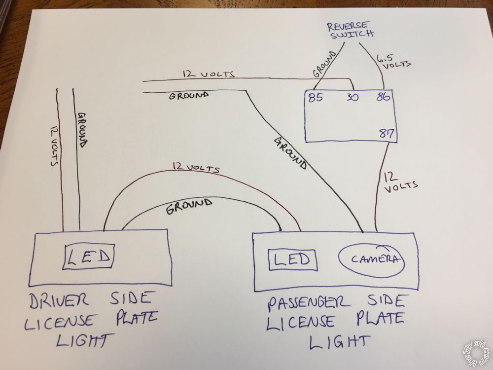

I was able to fish a red/black pair to the driver side license plate light and I tapped into that 12v and ground to power the LED in the passenger side camera housing. I reconnected the camera ground where I had cut it for testing purposes. I turned on the car and the camera housing LED was on independent of the camera being on. That was good. But the driver side license plate was no longer on. Woops, I put the driver side LED bulb into its socket backwards. LED has directional current. I reversed the bulb in the driver side license plate light and everything worked. Below is a clean wire diagram. Thanks for your help. On to the next project.
