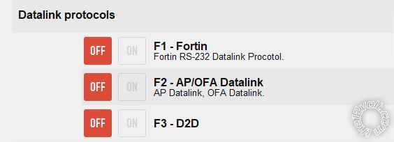

I can answer your question concerning compatibility between Fortin and Avital ( and all DEI products ).
Any of Fortins bypass modules can be used with any remote starter if connected W2W. This is a bit more
work during bench prep, hardwiring all inter-connections, but always yields good results.
I'm guessing you are wondering if the Fortin bypass module can use the Avitals DBI D2D connection. That is a
definite yes. Unlike XPressKits XKLoader2 flash procedure to flash the DB-ALL bypass module, when using the
FlashLink2 harness to flash a Fortin bypass module there is an option ( F3 ) that you checkmark that enables
the D2D port to communicate via the DBI protocol instead of the native Fortin comm protocol. With that F3
option selected you are good to go with a D2D harness connection to your Avital remote start unit. Fortin
modules come with a special D2D harness that has the standard red 4 Pin D2D connector for DEI products. Fortin
Modules can actually be flashed and set to communicate using 3 different D2D comm protocols, giving them wide
flexibility. DEI bypass modules do not have that option as far as I know. It's DBI D2D or nothing. This D2D
protocol flexibility is also true for iDatalink bypass modules using their ADS USB cable.
Directechs Accounts Shut Down? Alternatives? -- posted image.
You are right about Fortin being a bit more confusing. There is definitely a learning curve but that was true
with XPressKits when you first started with them. The big downside will be the access to DEIs wire listings.
Fortin has their WireColor site but it typically only shows the wires necessary for bypass module install and
not everything like DEI.
