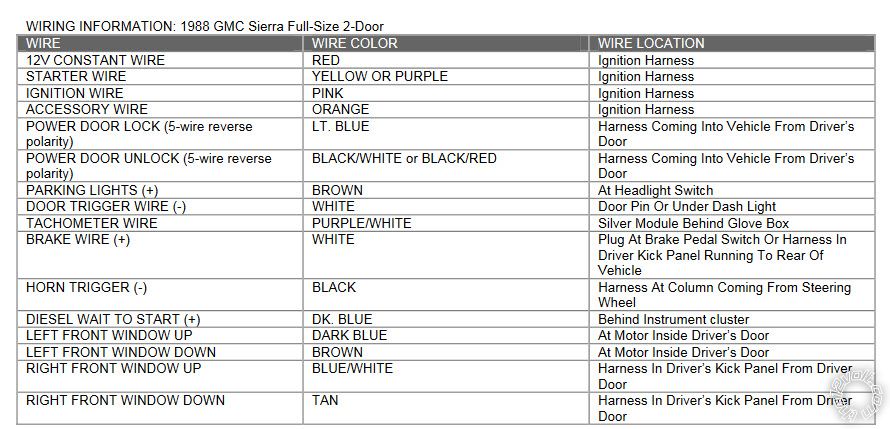

I am not sure If i picked the right orange and purple wires to tie into?
Do I need to tap into the ignition wires related to the key?
Did I get the right wire for the brake?

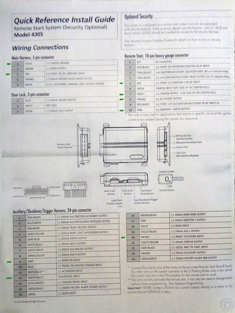

What is the minimum needed to make it start?
Do I need the door wire connected?
I did the hood pin, Tach wire, ground and the wires shown in the photos.
I have not hooked up the door locks as they need new actuators. That will be the next project after the starter works.
RED Wires:
The truck has 2 red wires, both are constant 12v. I tied into one of them.
The Viper has several red wires. I connected the red on, there is a red/black stripe and red/white stripe. Do they need connected? They have fuses, so I am guessing they need connected?
1988 wiring guide:
1988 Silverado C1500 viper remote starter -- posted image.
Wires I connected in green. Which are missing?
Quick reference install guide for Viper 4305v1

A few things: pins 2 on the heavy gauge harness needs to be connected to power, since it feeds the starter output. The brake wire should be correct, but you should always verify for yourself. You can do this with a multimeter, but a test light will work also.
You need to connect the door trigger, as this will be used for programming. The factory setting (if it's like the older units) is manual transmission, so you may need to change that as well. The parking brake wire may need to be connected and set, too (haven't been an installer for over 15 years, so maybe someone else can chime in).

Got it to start, now have a problem with the tach wire. That needs to be checked or configured.
Best advice I have for anyone else is to watch more youtube videos on viper equipment.
I never connected the door sensor and the vehicle starts. You need it to turn on/off valet mode, or other setting as mentioned above, so it will be done later.
Parking lights not connected yet.
Grounded the parking brake wire to disable Manual transmission mode.
I connected all of the fused red wires to a SINGLE 12v constant red wire shown in the photos above, you could use both wires, but one was enough for me. To answer my own question, I did not have to cut or mess with the ignition wires (so far). The brake wire in the photos has not been tested at this point.
It is nice to pop the hood to kill the starter (hood pin switch) when having problems during testing. Hood pin was installed between the washer fluid and the head light.
