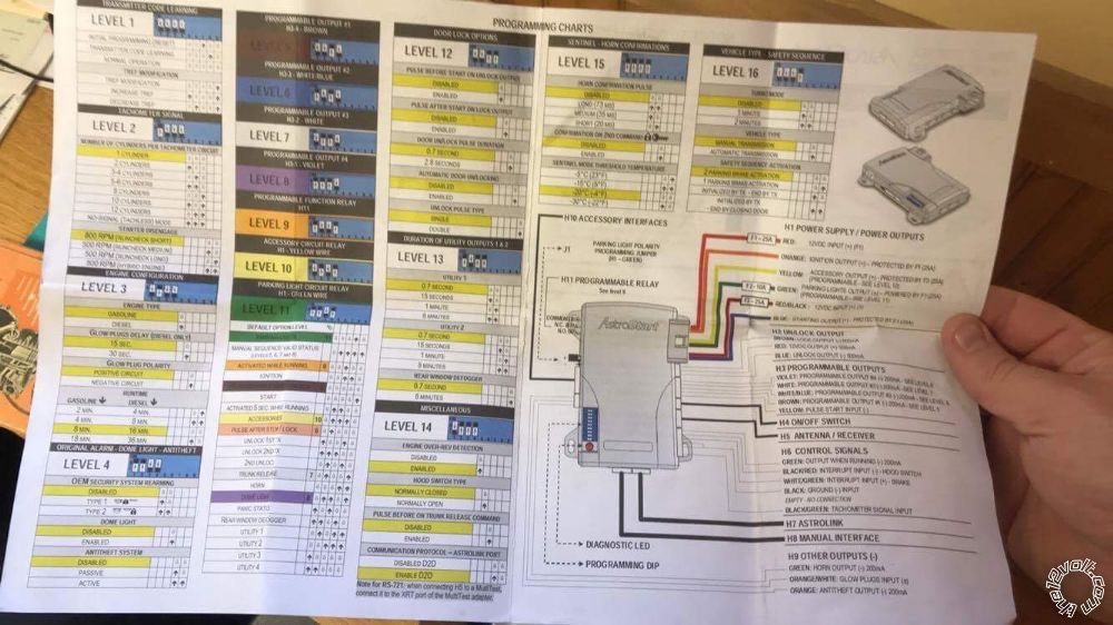

Went to buy a used unit from a guy on facebook. Got there and several wires missing. He went ahead and gave it to me for free. I have only done a couple of remote start installs. This one is a bit different than what I have seen.
I am wondering how you program each level? Looks like it has something to do with the dip switches. The H-1 harness/wires are missing. Just wondering if someone could tell me what wire goes on what input on this unit. Has two rows of 3 plugs. I have the diagram shows what six wires go on there, but I am not sure what three go in the top row and what three go in the bottom row. Red and Orange go in the first two 12V DC and Ignition output, Yellow and Green go in the middle two Parking light out put and Accessory output, Red/Black and Blue go in the third spot 12V DC and Starter output. Just not sure if it is red yellow red/black in the top or if Orange Green and Blue go in the top row.
Any help would be greatly appreciated.

I am going to pull out a ready remote, I currently have in a 1996 Grand prix. Would like to replace it with this unit as it has two way confirmation.

Astrostart RS-721 -- posted image. Wires that are on the top right are the ones in question. Six wires.
