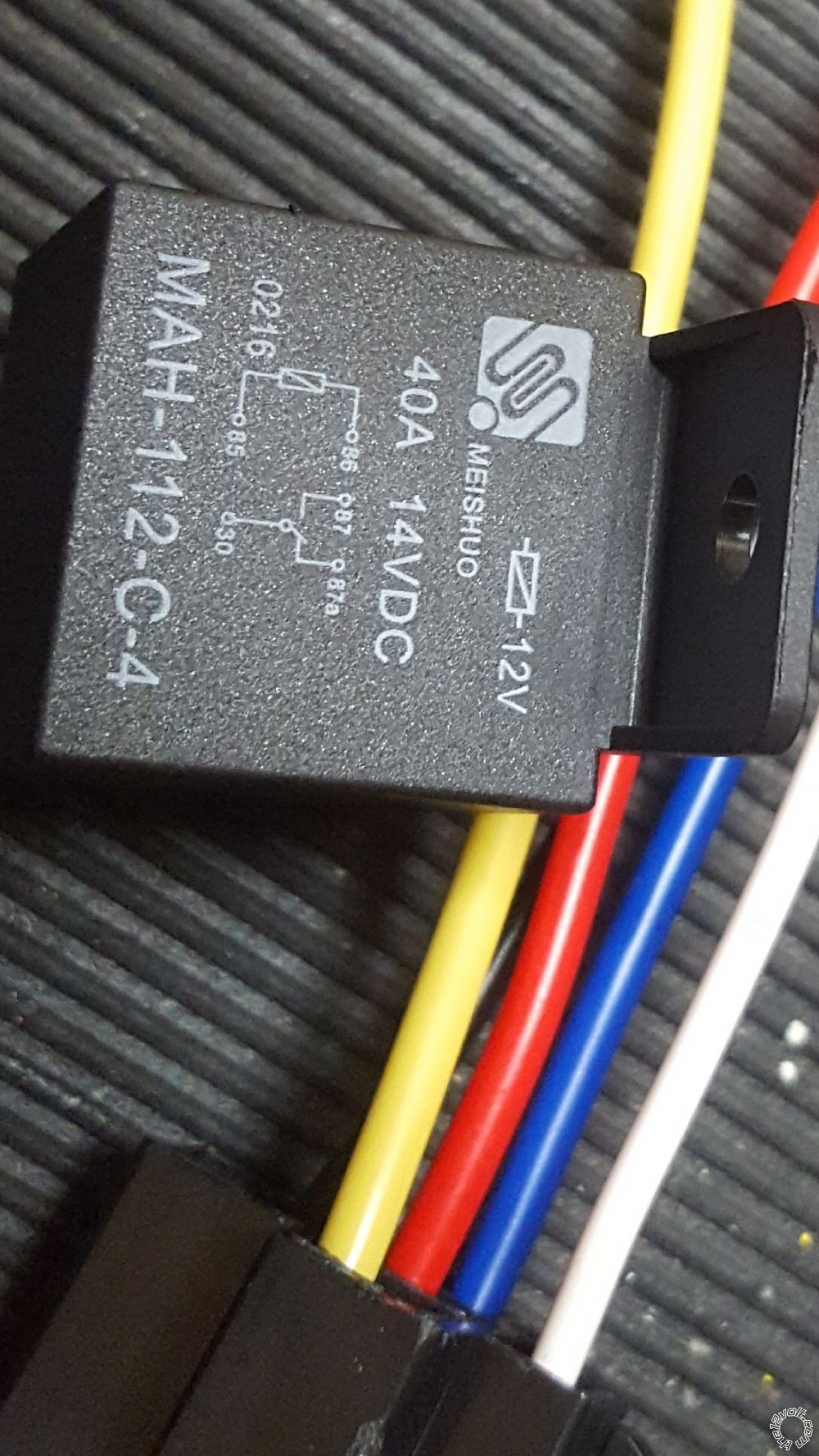

Thanks jeepherder! Thats exactly what I needed! Would these relays work for this polarity conversion?
Can I also use this relay for the anti grind relay? I guess what Im asking is if it is the correct type for both applications (40a 14VDC). Of course I know that I will need 2.
2016 Ram - Horn Wire -- posted image.
Chris
geepherder
Platinum - Posts: 3,668
Joined: October 27, 2003
Posted: December 31, 2017 at 3:33 PM / IP Logged Link to Post Post Reply Quote geepherder
Yes, those will work just fine.

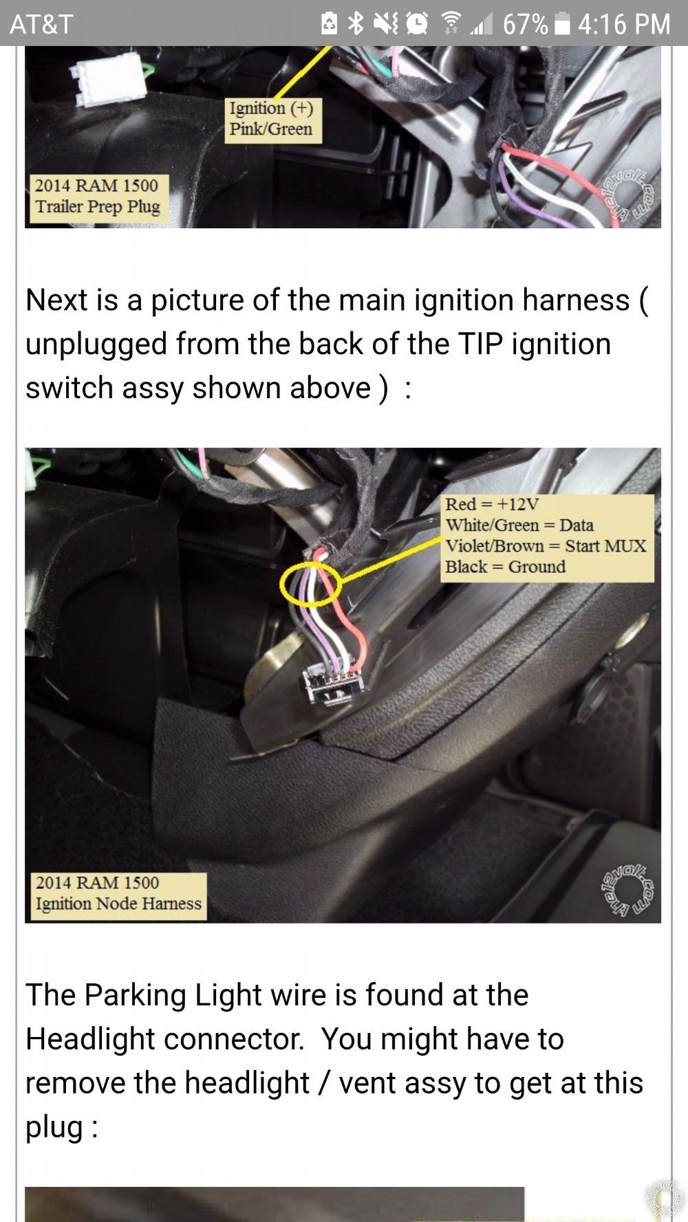

One more question! Below is a pic of my ignition plug. Would it be correct by wiring the anti grind relay- 12V constant (red) to the 86 pole and the starter wire (violet) to the 30 pole and then again after cutting the (violet) starter wire to the 87a pole. 85 goes to (-) controller.
Chris
geepherder
Posted: December 31, 2017 at 4:39 PM / IP Logged Link to Post Post Reply Quote geepherder
https://www.the12volt.com/installbay/forum_posts.asp?tid=90800&tpn=1
The above listed post has an explanation for wiring the anti grind relay.
