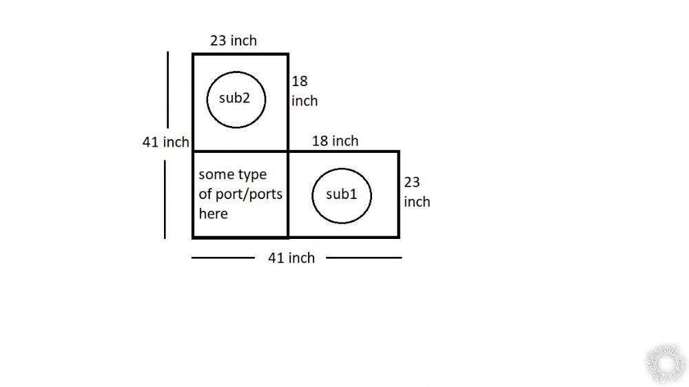

hi all, i have a 3200 rms amp pushing 2 SoundQubed HDC3.118's....was wondering if an L shaped box like this would even work? Think of a sectional couch shape lol. trying to come up with the space to use these subs. thank you. here is the design i was thinking, your looking down onto the box, subs will be facing car roof unless u think that's a bad idea.. Can a Subwoofer Box Be in the Shape of an L? -- posted image.

Should work fine as long as you size it and the ports properly for the drivers you plan to use. Enclosure shape really doesn't matter.
