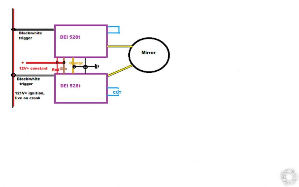

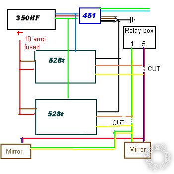

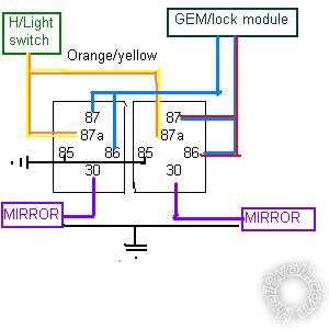

Posted: February 03, 2018 at 10:06 AM / IP Logged Link to Post Post Reply Quote howie ll
That's the safest.
Here's another:-
And another!:-
