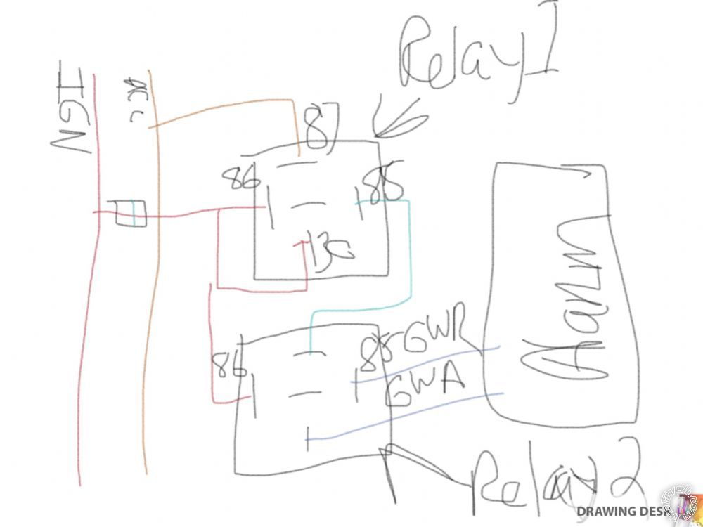

As for the starter kill you are going to need two relays and a diode
Tap the ignition wire with the cathode of the diode towards the relays
On relay one attach ignition to pin 86 and 30, also ignition to 86 on relay 2
Relay on pin 87 to accessory wire, pin 85 to relay 2 pin 87a
On relay 2 pin 30 attach ground will armed
On relay 2 pin 85 attach ground will running
DB3 Interface Silverado/Sierra lock settings? -- posted image.

Awesome! Thanks!

Posted: February 20, 2018 at 4:04 PM / IP Logged
Note that this is only going to work on gms with this type of ignition
