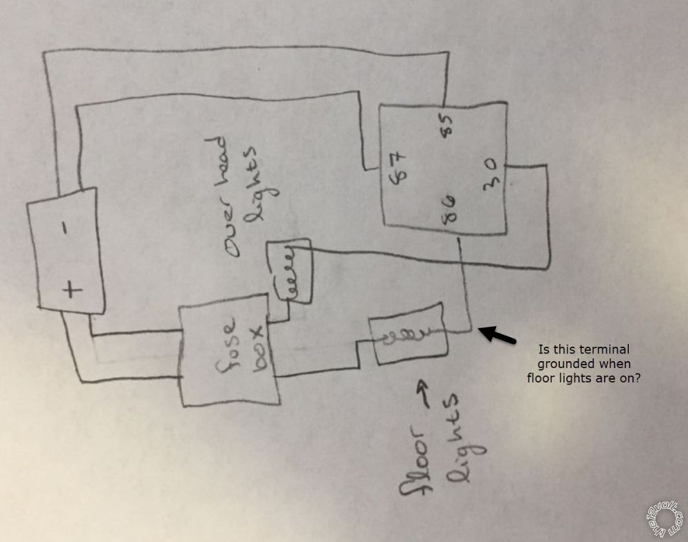

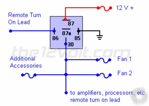

Are you doing something like this?
Where remote turn on connects to your floor lights and additional accessories side connects to your dome lights.

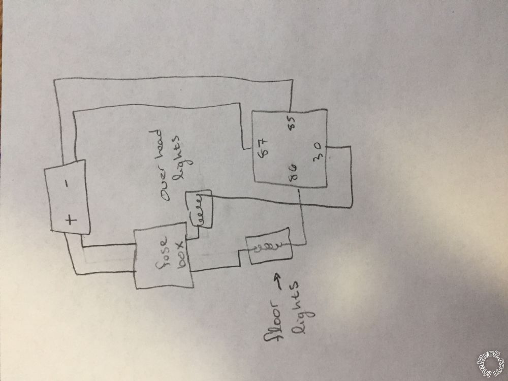

Posted: March 05, 2018 at 1:28 PM / IP Logged Link to Post Post Reply Quote jfar164521
Relay Circuit, Floor, Overhead Lights -- posted image.
Hopefully this explains the two circuits best. I do not know if a relay is the right piece of hardware in order to connect the two circuits but if there is another component that would make this work the way I wish, please let me know.
eguru
Copper - Posts: 340
Joined: February 04, 2018
Location: Quebec, Canada
Posted: March 06, 2018 at 7:28 AM / IP Logged Link to Post Post Reply Quote eguru
If the answer is 'Yes' to my question, the relay coil (85&86) isn't being energized - you would need to connect 85 to +12V instead of ground.
When you manually power up the dome lights - are you connecting a ground wire to the terminal that is connected to 30 on the relay?
