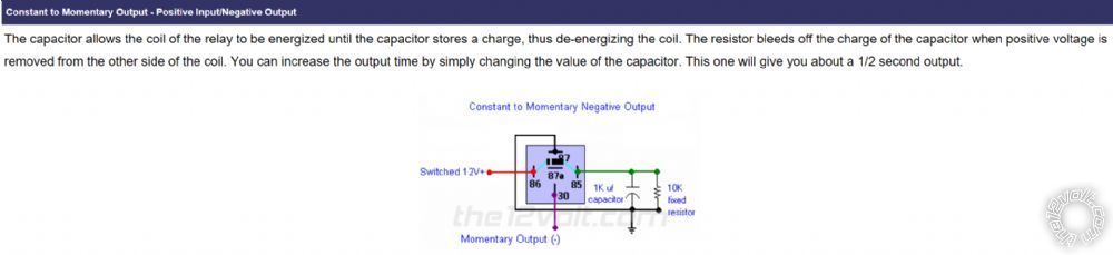

Leave the resistor in parallel with the capacitor to discharge the capacitor before the next chirp.
I can't tell from the picture - but do you have both the capacitor and resistor in parallel across the relay coil (instead of in series per the diagram)?

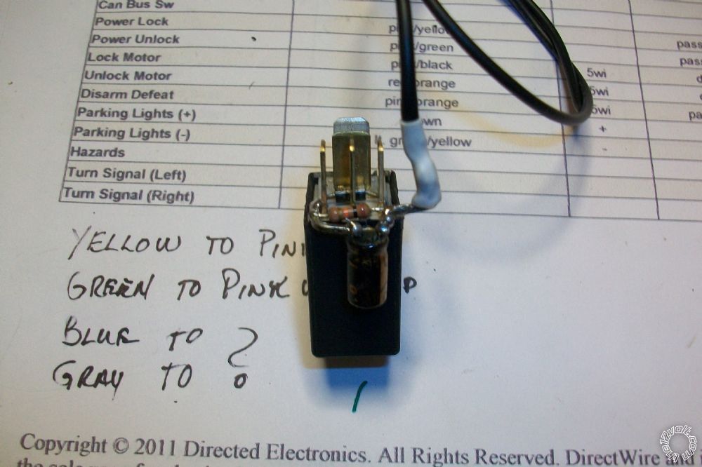

Thanx for the reply's,
I think I have it just as the diagram shows.

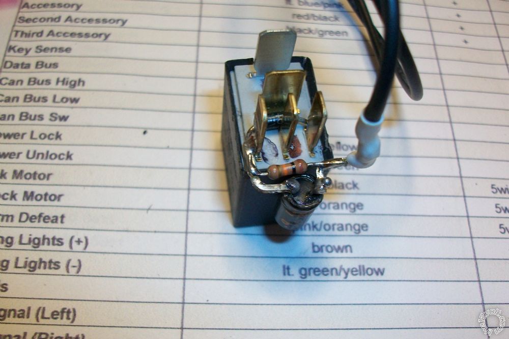

Here is a pic. of my next try, I decided to use a little more dependable relay.
Shorter horn chirp? - Page 2 -- posted image. Shorter horn chirp? - Page 2 -- posted image. Shorter horn chirp? - Page 2 -- posted image.
So the attached black is to ground and the rest will wire per. diagram.
Any thoughts, warnings before the fire flys.
I am also trying a 220uf 16v cap. I am looking for around 0.25 or lower.
Thanx again for all the help,
John A.

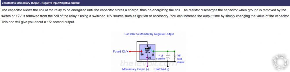

Usually the output from an alarm or remote start that honks the horn is negative going so it would seem that what you really want to configure is this.

Worked great, gave about a .15 second chirp, but while installing it I found out that P.O. or installer wired the horn chirp on there own by tying into the only wire that's active when lock command is given at the remote, that's a 2 second positive output. We then tried the horn button and poped the horn fuse. Then we tried the locks from the switch in the truck and found they also give a .15 sec. chirp.
So my next question is where do I install diodes to prevent the chirp when the switches in the truck are activated and prevent the blown fuse when the horn is used. Or can it even be done?

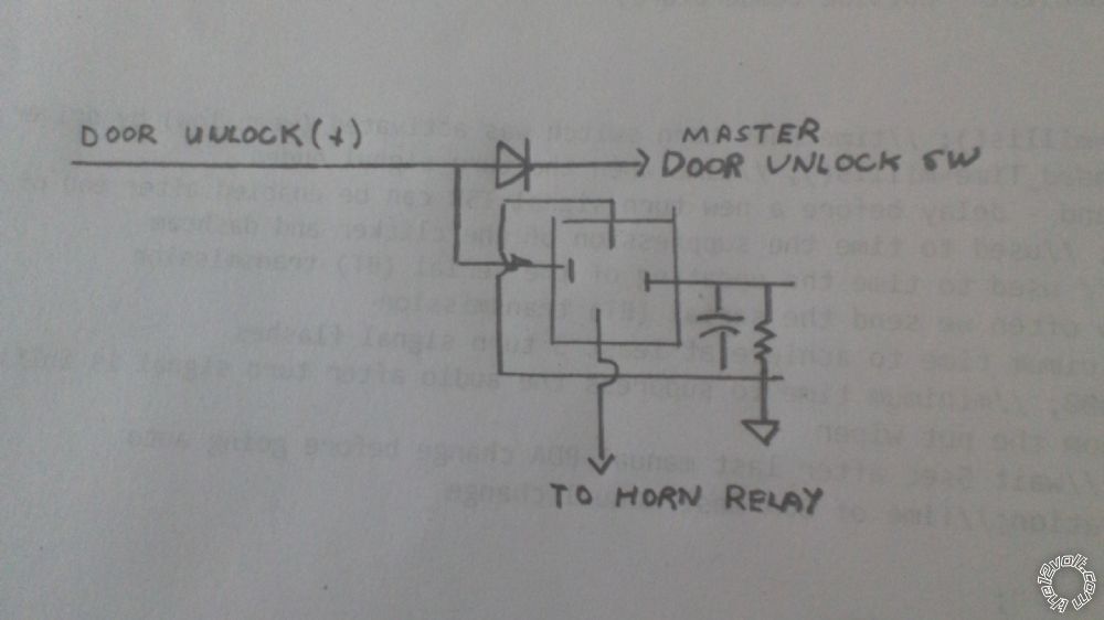

If you modify the circuit to trigger from the positive going unlock output to create a momentary negative going pulse for the horn, that should fix all the issues.

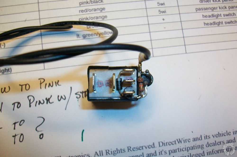

To fallow up on the outcome, The constant to momentary negative worked great.
Can use horn without blowing fuse and using a 220uf gave me a nice short chirp BUT,
horn still chirps when operating lock and unlock from the switches inside truck.
I think this can be solved with diodes but i'm not sure where to locate them.
Up at the switches, down at the unit, at the horn connection?
I could use a little guidance here.
Thanx you for your time,
John A.
John B.

You will need to add a blocking diode to your door unlock circuit. Shorter horn chirp? - Page 2 -- posted image.
