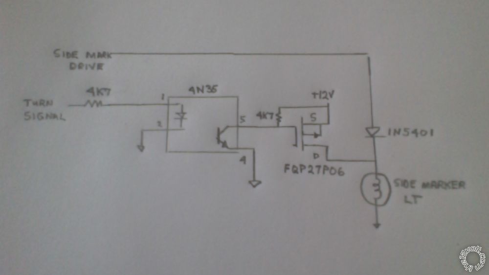

Does anyone have a wiring diagram to convert a turn signal light to be a parking light also and vise versa? Trying to make my rear turn signal a parkingight also and my front corner marker to flash with turn signal. Thanks for any help.

Using relays if possible or a way where you don't have to run a bunch of wires. Thanks.

Try this for the side markers.
https://www.homemade-circuits.com/customizing-car-side-marker-lights-to/

This is an all solid state design. No relays so no switching spikes getting into your electronics.
Just uses an opto-coupler, a diode, and p-channel MOSFET
