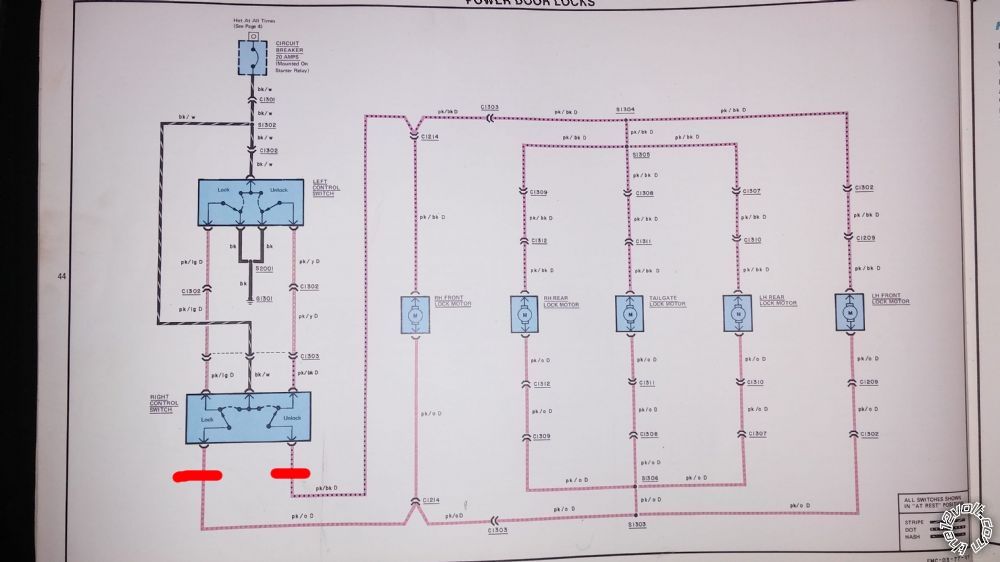

Tearing my hair out here. I've done probably half a dozen alarm installs over the past 20 years and have never had an issue. Helping my father out with his 77 Ford Country Squire wagon with a keyless entry. I've never seen this type of locking setup, and I can't quite match it up with the types listed.
Rather than make a wiring mess. I could really use some help here, as I'm in over my head.
Diagram from Ford wiring diagram booklet below.
1977 Ford LTD - Lock ID with Diagram -- posted image.
Description of operation.

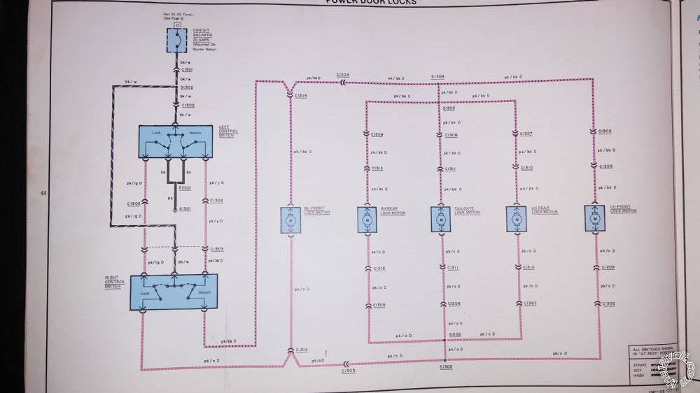

Found the harness along the top of the dash, luckily. I should be able to find the actual solenoid wires (red hash marks, mine) vs the wires between the switches.
Ween
Platinum - Posts: 1,368
Joined: August 01, 2004
Posted: April 16, 2018 at 11:22 PM / IP Logged
I'd say try, but it won't work. If you notice connector C1303 is on the input side of the switch as well as downstream of one of the door lock motors.
That tells me C1303 is probably in the kick panel. The wiring marked by the red dashes is in the door. Making more work than is
necessary. And if you can find the pink wires with the traces (the ones between the lock switches) at the top of the dash, then use them.
If you tied into the wiring coming out of the right door, then that door wouldn't operate.
