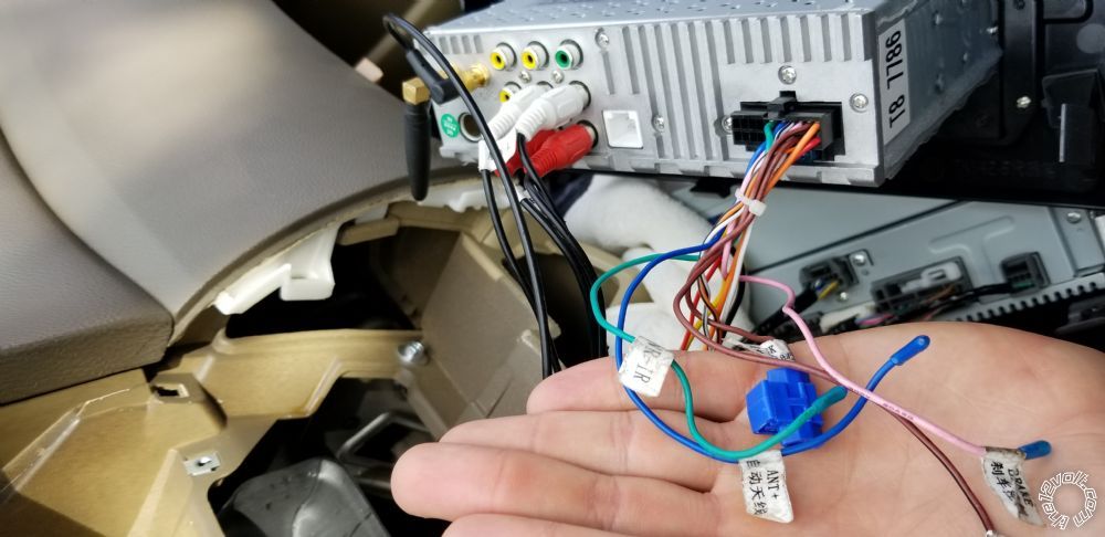

The navigation system came with all cable is conect to the factory radio i buy the antenna adapter for checking is the problem today i need conect the antena to the aftermarket wire and blu with blue and 12v for checking the audio go back because when my conect the big oem wire back to the factory the audio is back back i think the problem is the aftermarket harness not send power to amp

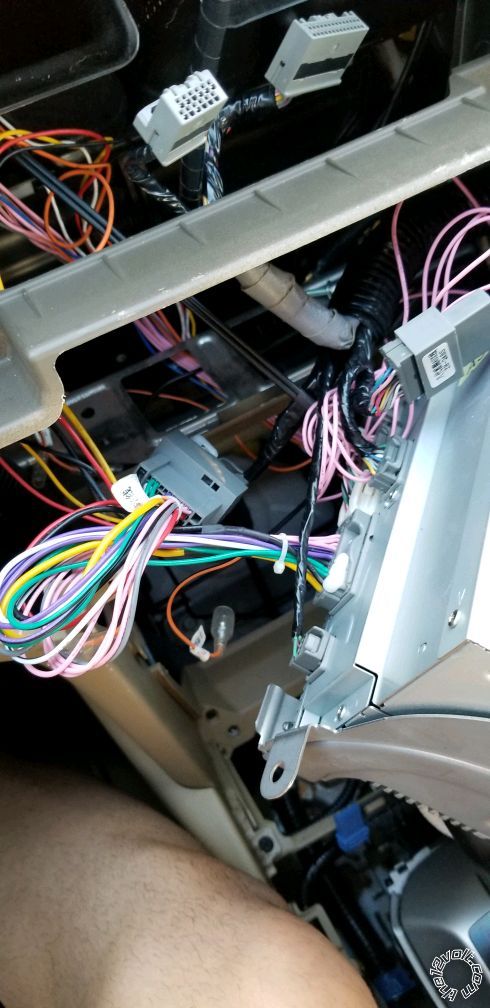

2008 Honda accord ex, gps audio -- posted image.
Platinum - Posts: 13,728
Posted: May 15, 2018 at 12:56 PM / IP Logged Link to Post Post Reply Quote i am an idiot
Factory Amp Turn-on      white      +      radio, gray 24 pin plug, pin 17

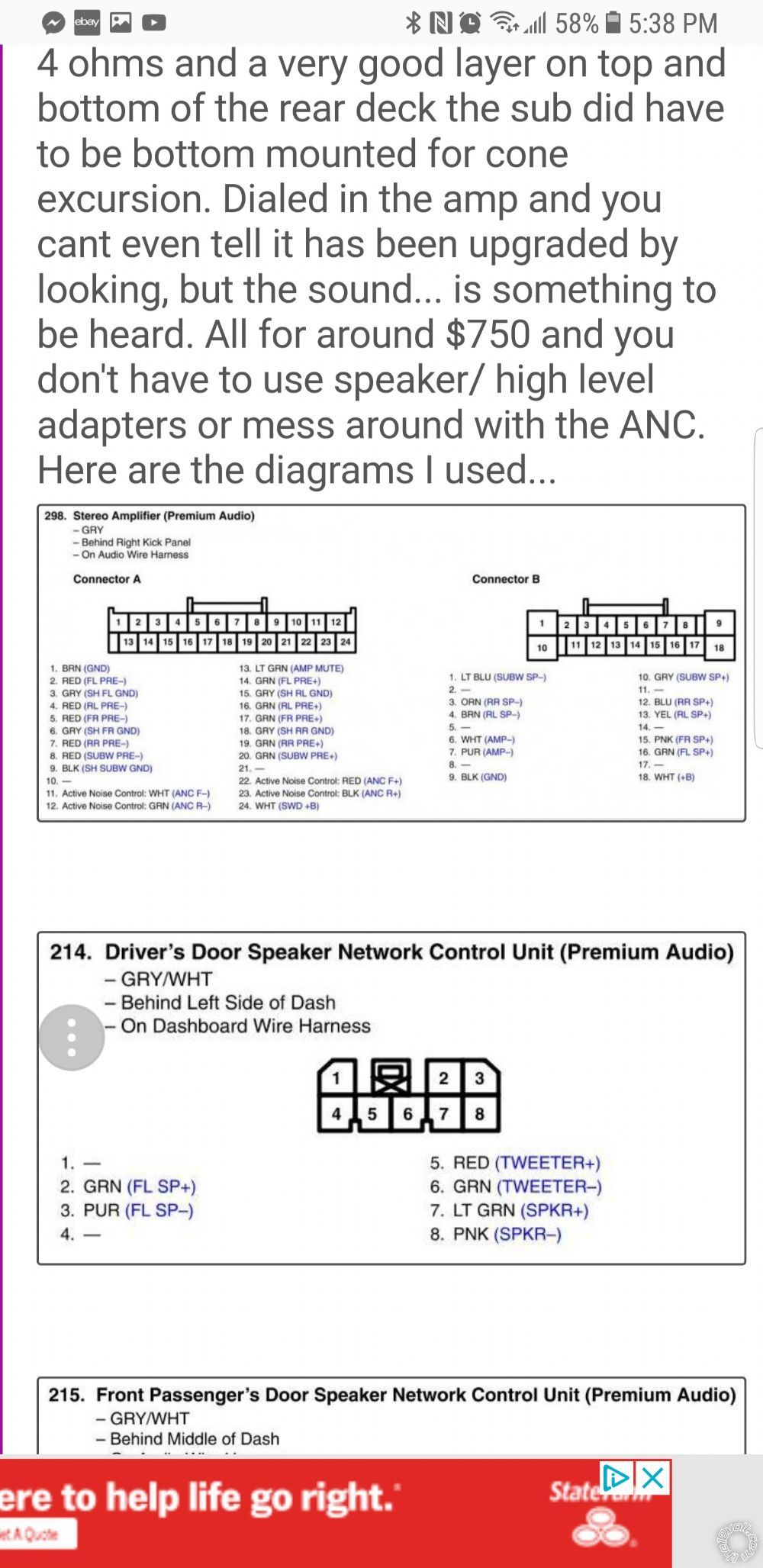

vidente
Member - Posts: 7
Joined: May 11, 2018
Posted: May 15, 2018 at 2:26 PM / IP Logged Link to Post Post Reply Quote vidente
Look the pic i need know is like this pic and thanks

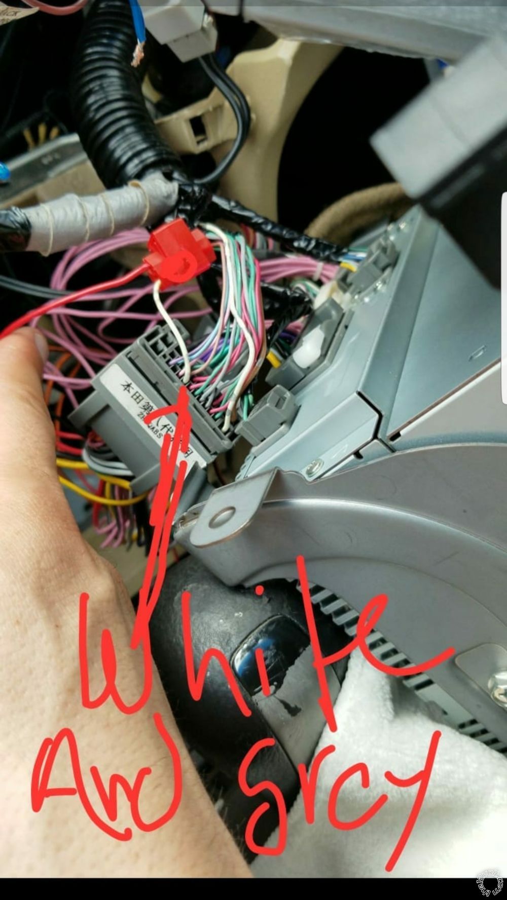

I done my radio have sound the cable is white and grey conect to 12v thanks everyone for help
