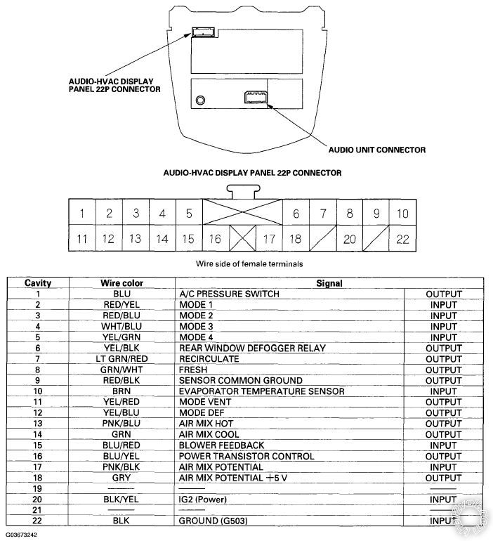

So, I've found this list for my, single zone HVAC unit:

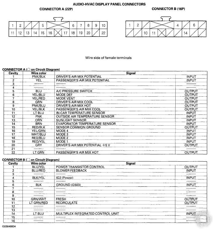

...and also for dual zone HVAC (the Chinese radio in this case):

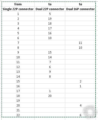

I have rearranged the wires in the following way:
7th Gen Honda Accord Radio Chinese, AC -- posted image.
Unfortunately it didn't work. I’ve used a “spare” 22P plug with a foot of wires, which I received as a “bonus” with one of the factory radios I purchased from a junk yard (I think an employee didn’t bother unplugging the radio, and just cut the harness… barbarian! ). I’ve opened the plug, removed all wires, and rearranged them for dual zone unit. For the 16P outlet I’ve used loose wires (insulated with electric tape) from this plug as well. For a split second I thought it worked, because the air was blowing. I left the blower on intentionally, when I was disconnecting the factory radio. Unfortunately none of the HVAC buttons on the Chinese unit worked… So I declare:
