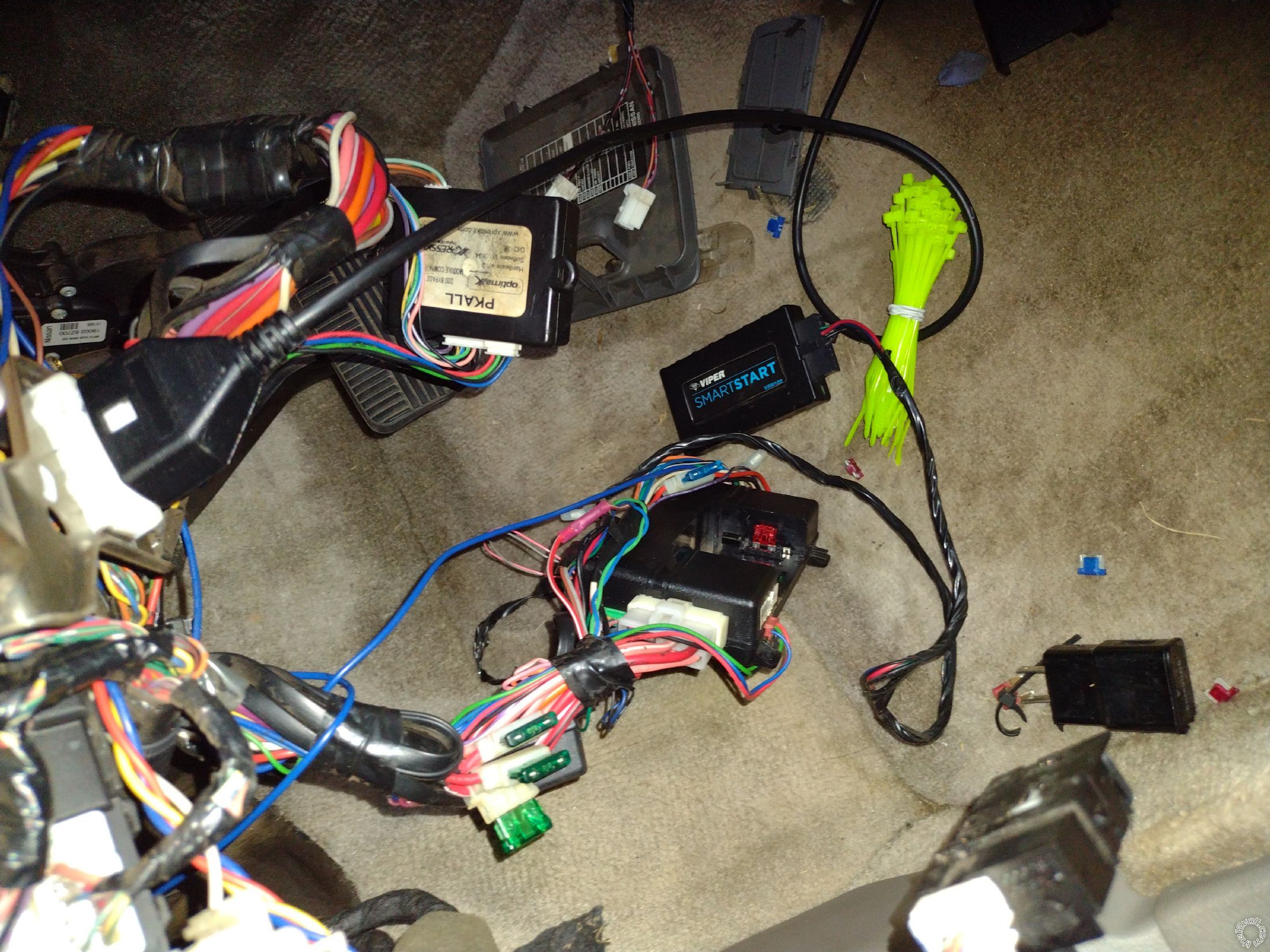

Hi all. I recently picked up a 2001 Nissan Altima GLE and am trying to bypass the immobilizer using a "Directed Electronics Inc PKALL Xpress Kit Data Transponder" that i picked up from amazon. The security has been playing games and its time to simply bypass and be done with it.
My problem is that when I reference the install instructions, the wiring does not seem to match up exactly. I have checked out the wiring diagrams on the12volt and havent found them to match exactly either, so Ill provide pictures here of what is not lining up and hopefully someone can help me out.
As you can see, the immobilizer harness has 5 wires in an 8 pin harness, however the pins the instructions ask for do not correctly correspond with what I have.
Thanks in advance

I'm not well versed in security issues much at all, but have found a nats diagram online that appears to say Brown is IGN, green/orange is security light, light green/red is possibly data? it goes to ecu from this harness so Im assuming on the last one there.
My goal is not to actually set up a remote start or anything, I was just hoping this would bypass the immobilizer from stopping my normal key from starting the car is that not the case with the device i picked up? I know i can't completely disable the system but was hoping this would keep me from having to shell out a bunch of cash to maybe reprogram a key that was working completely fine and hope that it doesnt just magically stop working again.

I bought a 2001 Nissan Altima GLE with 140k miles as a beater for back and forth to work. Drove it for about a month during which the original key and fob worked perfectly fine. I left it sitting for 2 days while I was off. When I was headed back to work after the 2 days, I hopped in, the car started perfectly fine and ran for a few seconds before shutting off and illuminating the security light. After that it cranks the engine but will not fire at all.
Since then it has remained in the security no start condition. I have left battery disconnected to maybe reset the sec. system, tried to relearn the key via the "cycle the key x amount of times for x amount of seconds" methods for the NVIS/NATS systems i found online, tested the battery, tried getting a new chipped key cut, the misguided immobilizer bypass attempt, and the locksmith who was unable to communicate with the ecu.
After a little more research today I found accounts of a failure to communicate with the ecu response in programming tools for this car to point to a bad immu on many occasions. Again, not sure on this security stuff, I work as a mechanic but this is definitely an area I know very little about.
