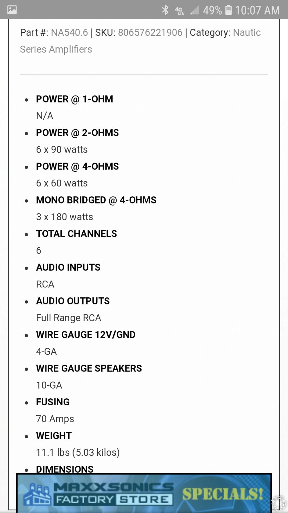

First IF I get this amp I will be running only one sub and 4 door speakers.(its used)
My question is, I am looking at the specs and I understand ohms and channels and all that. What I don't get from their spec sheet is what the sub will be pushed at when bridged.
If anyone could be of any help.
Thanks a bunch.

Assuming your subwoofer is a 4 ohm SVC or a 2 ohm DVC subwoofer (voice coils wired in series), and you're only using two channels bridged mono for the subwoofer, then it will be 180 watts at 4 ohms to your subwoofer.

Also, since the amplifier is stable at 2 ohms per channel, if you have a 2 ohm DVC subwoofer, you can wire 1 channel of the amplifier to each coil. It will be 90 watts at 2 ohms per coil or 180 watts total to the subwoofer. So whether you run two channels stereo or bridge mono, it will still be 180 watts total to your subwoofer.
Please tells us about your subwoofer. Is it a SVC or a DVC woofer and what is the impedance of each coil?

You have other power options depending on your head unit and your preferences. You could power the rear speakers from your head unit, the front speakers from 2 channels of the amplifier, and the sub with four channels of the amplifier if you use a 4 ohm DVC subwoofer, which would give you 360 watts to the subwoofer.

So use channels 3 and 4 bridged for one voice coil and channels 5 and 6 bridged for the other voice coil?
