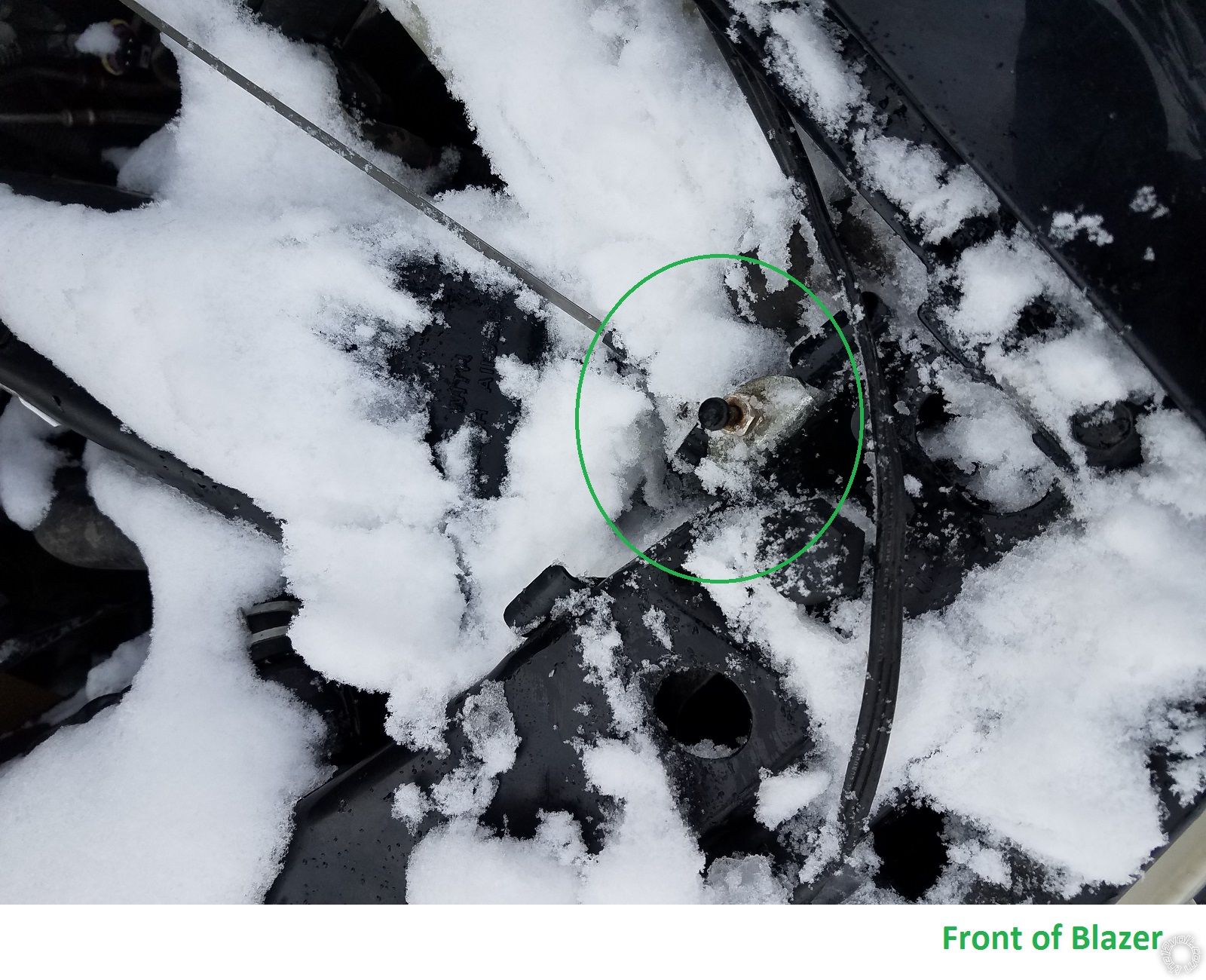

Hood Pin. I bolted mine in same place as the attached photo. Between the plastic tabs that hold on the drivers headlight. I used a small piece of angle iron to make the same setup, mine is more to the left, still between the tabs.
Blazer Jimmy Hood Pin location:
Chevy Blazer S10, GMC Jimmy, Sonoma 98-05 Remote Starter 2nd Ignition -- posted image.
