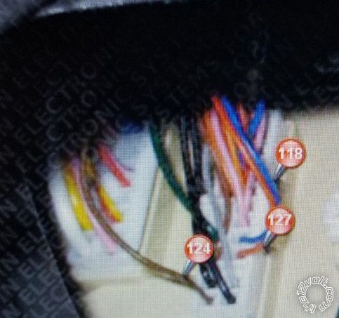

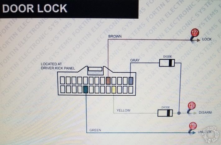

I am installing a remote start on 2011 Kia Soul for a friend and according to Bulldog Security It says TYPE B (-) for lock and unlock at the driver's kick panel ( Brown and Green ) but for some reason I can't make it work. I read up on TYPE B locks and it says that it required positive pulse so I changed the polarity to positive via relay and still doesn't work, did anyone come across this? Any help would be appreciated.
Thank You in advance!

2011 Kia Soul Type B Lock & Unlock -- posted image.
