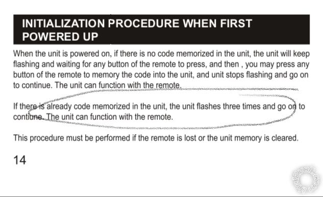

Bulldog has tech support and can better answer any of those questions. Why wait on connecting the parking light. It indicates what the unit is doing during normal operation and troubleshooting, so connect it.
The 3 clicks upon plugin would appear normal from my quick perusing of the manual. 2000 Camry With Bulldog RS82B -- posted image.
RS82B install manual
Did you wire up the tach and go through the learn procedure?
Also the hood pin needs to be hooked up and be grounded to remote start. If you didn’t hook it up yet try temporarily connecting it to ground before attempting to remote start it.

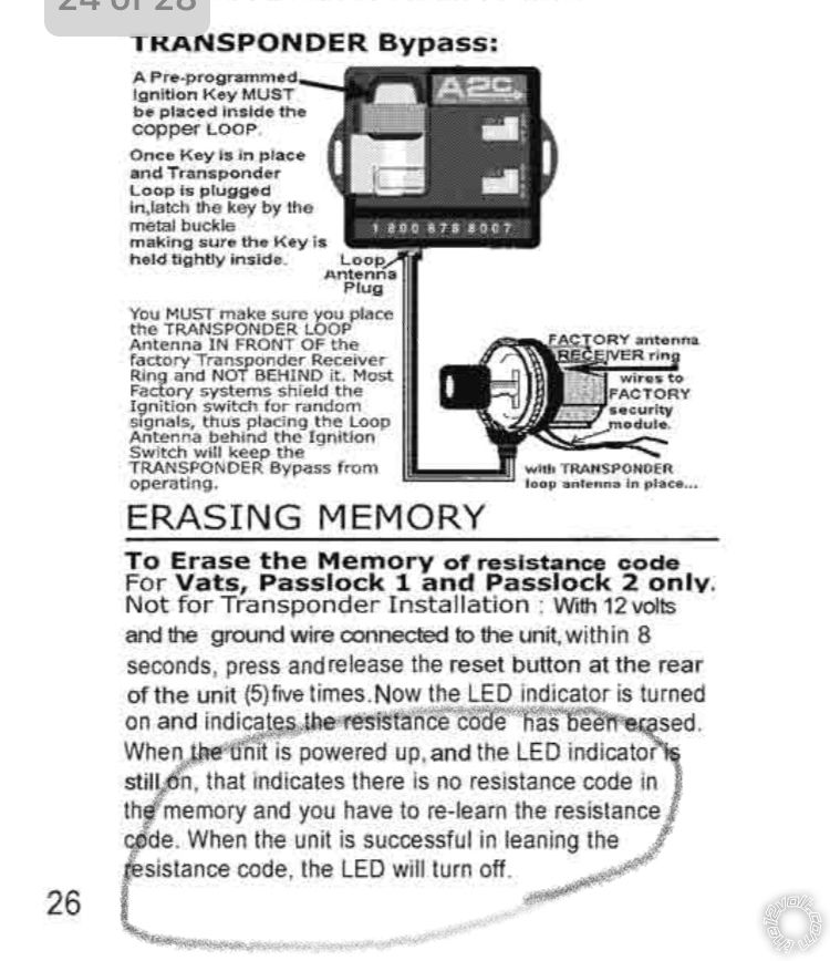

Posted: November 25, 2018 at 2:20 PM / IP Logged Link to Post Post Reply Quote iskidoo
michael213 wrote:
I started the car manually and now the red light on the unit will not turn on when it is plugged in.
So couple questions?
Is it supposed to be on?
That answer is in the manual as well.
