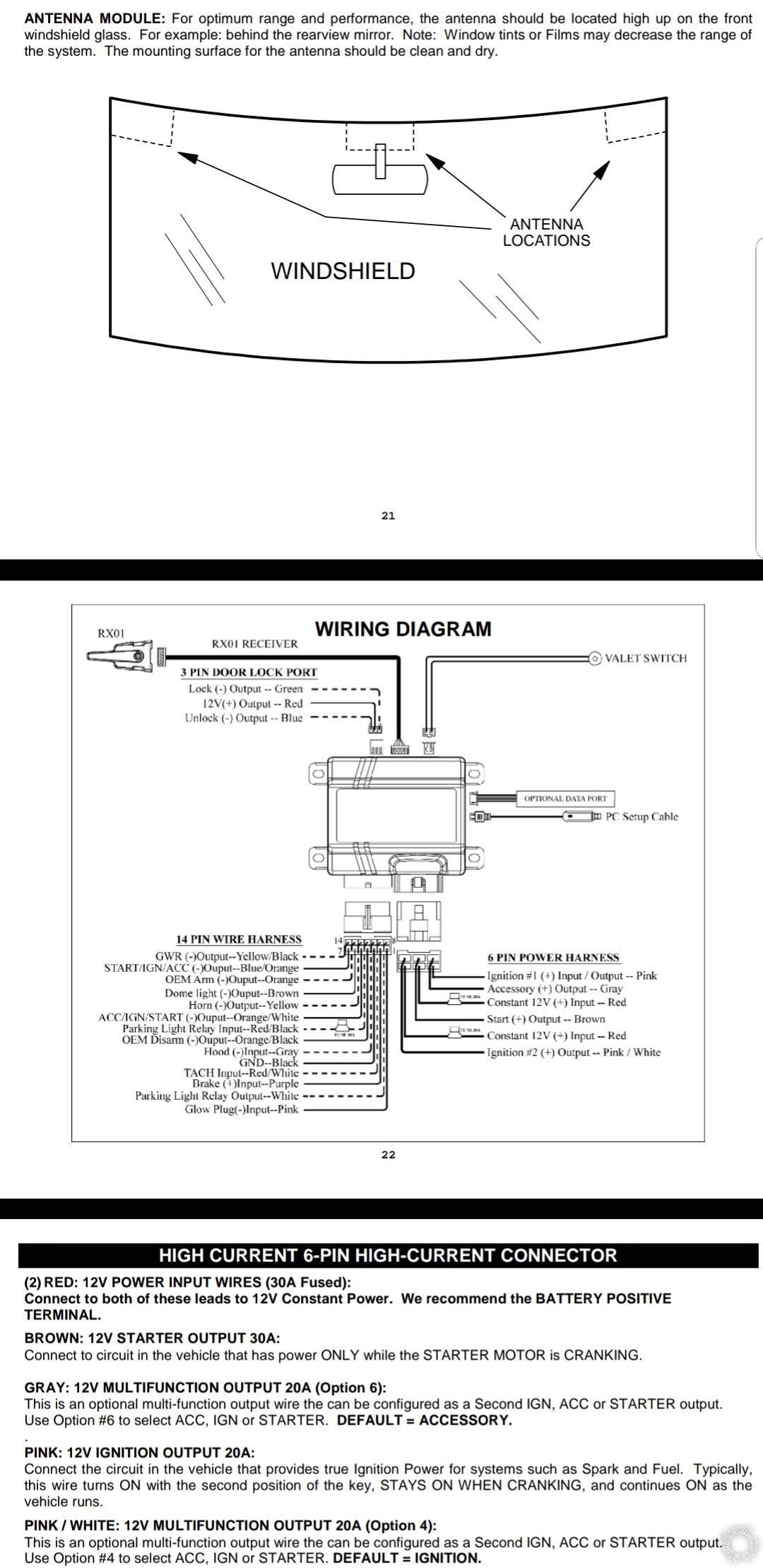

I do have another question I'm using same remote start soon in my friends 2016 Subaru Crosstrek it has a regular key.
His car calls for 2 IGN. 2 Start 12v constant and Accessorie.
The RS2-G3 only has one start wire. But I can program the Accessorie wire to be a second Start wire or program the IGN 2 to be a start.
Can I do without one of these wires or connect some of them together?
Thanks in advance.
