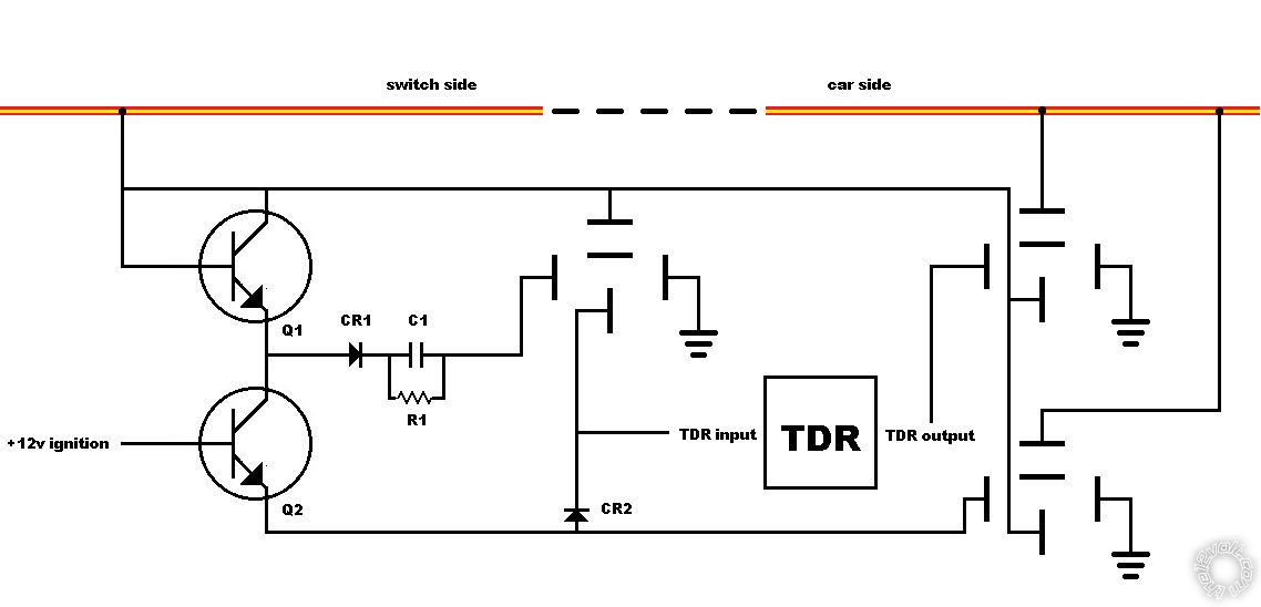

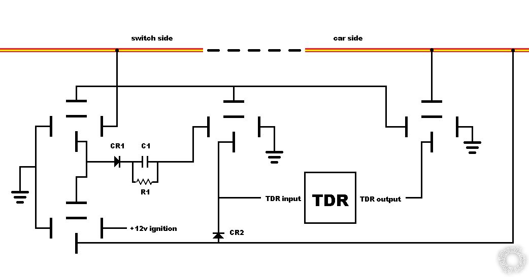

It works in my head, but it's untested. Maybe you can proofread it for me. You'll cut the headlight wire behind the switch (which I believe is red/yellow). R1 is a bleed resistor, 1K ohms or higher. You may need to try different values for C1. CR1/CR2 are standard switching diodes.
This will eliminate the excess current draw of the initial diagram.
