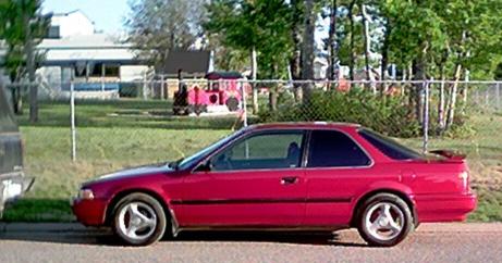

k, i will try it if money falls in my lap. I have a 91 Honda Accord. It's nothing special but its still my baby..I just got it painted, however i did not get to choose the color because i was in a different country, (don't ask). Anyways, its not as purple as it looks in this picture.

Not bad at all, doesn't really look too purple to meUnstoppable Trunk Rattling? -- posted image..   I'd take that car any day!....lol that is, until my G35 gets built and shipped here from good old japan (3-4 months they're telling me!!!!)
