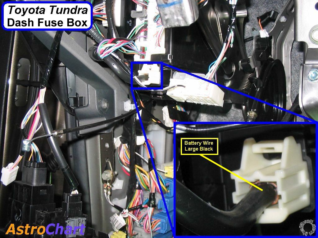

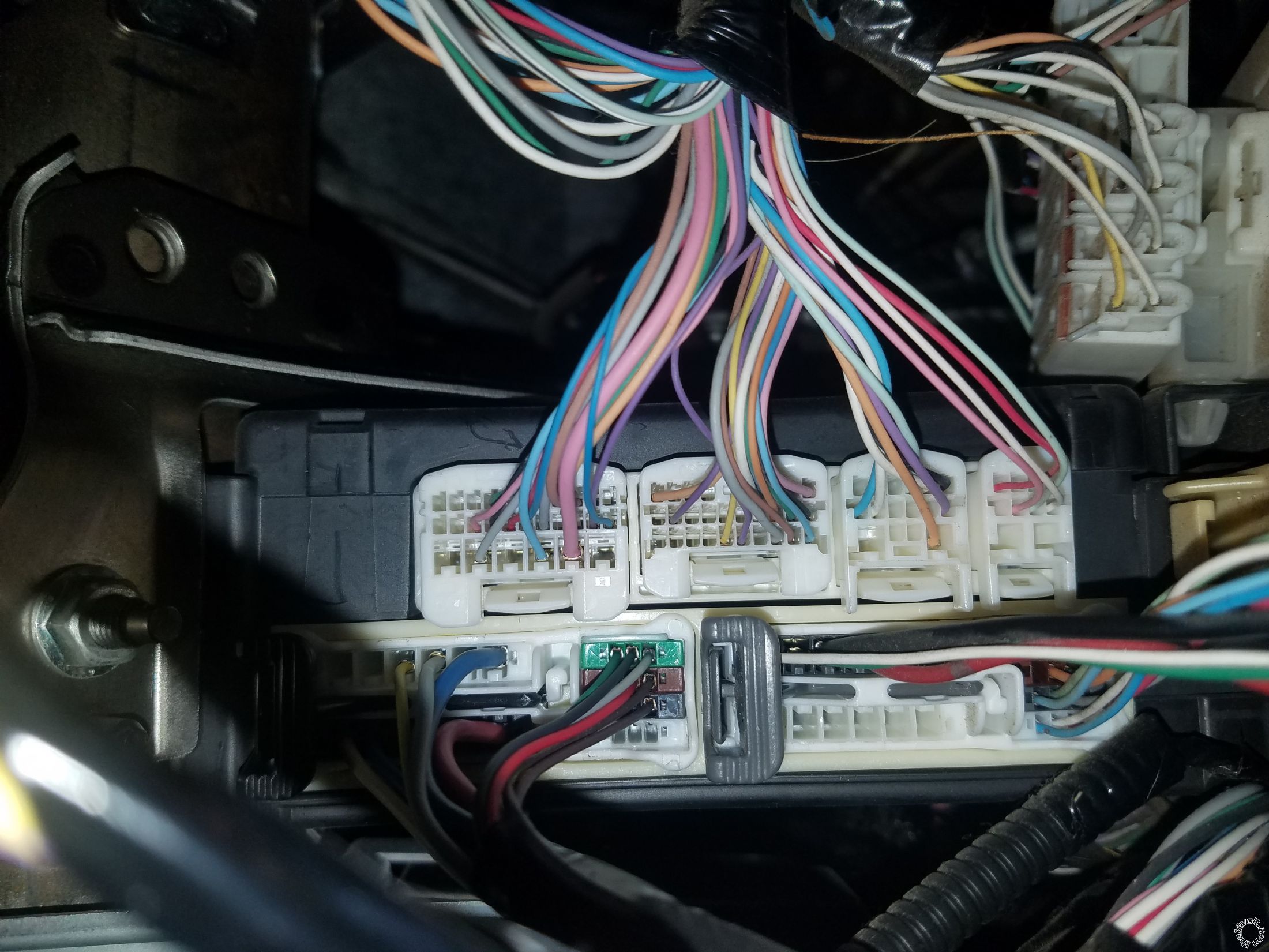

Trying to figure out what each plug is that goes to the dash fuse box... 07 Toyota Tundra, Dash Fuse Box Side Connections, 12V Constant -- posted image.

What are you trying to do?

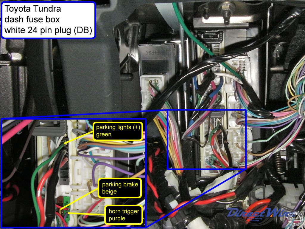

Trying to find the "parking light out" wire in the "24 Pin Plug" in the dash board fuse box.

Thanks for the help. I do appreciate it. So, all I have do now is find the "constant hot" wire and I will be done.

07 Toyota Tundra, Dash Fuse Box Side Connections, 12V Constant -- posted image. Looking for the "Constant Hot Wire".

I am looking for the locations for the "Constant Hot 12V". I trying to tie in my remote start for my truck. Any ideas and information welcomed..
