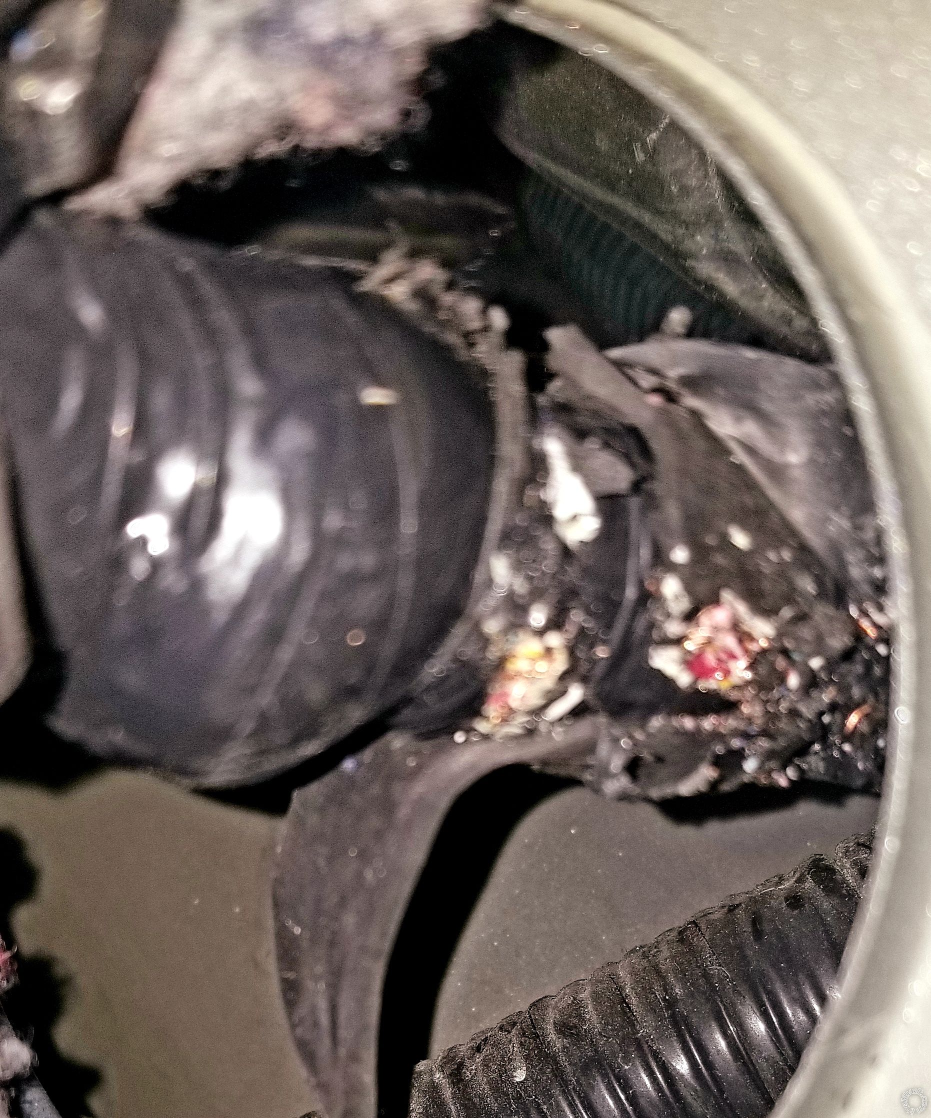

Posted: December 25, 2018 at 9:00 PM / IP Logged Link to Post Post Reply Quote samthesame
def a rodent or a big rat chewed my shyt up ughhhhh i remember i gently passed ut thru . it looks bitten all over08 Nissan Versa, No Start, No Comm with ECM After Front Speakers Install -- posted image.
