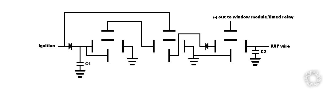

Auto Closure of Vent Windows -- posted image.
I'm sure there's a better way to do this, and it still requires a window module (DEI 529T/530T/535T) or a timed relay.
C1 must have a higher value than C2. C1 can be 220uF and C2 can be 100uF. Make sure they're rated 16 volts or higher.

Sorry. If you Google something like "Bosch automotive relay" and look at the image results, you'll see the terminal configuration and it should make more sense.
Also check out the relay section of this site for a working explanation on relays.
The triangles with the lines at the end are known as diodes and the line signifies the negative side.

Posted: December 29, 2018 at 7:04 PM / IP Logged Link to Post Post Reply Quote geepherder
Yes that's actually a simpler version of my diagram and would work.
The reason I added the two other relays was so the output would only be activated if the key was first turned to the ignition position.
Say you already had the windows down and wanted to wait in the car for the wife, girlfriend, etc. If you used the one relay diagram and just turn the key to the accessory position so you can listen to the radio, the windows all roll up. But you wanted them to stay down.
That's really the only thing difference. Just so you don't get annoyed by having to roll them back down.
