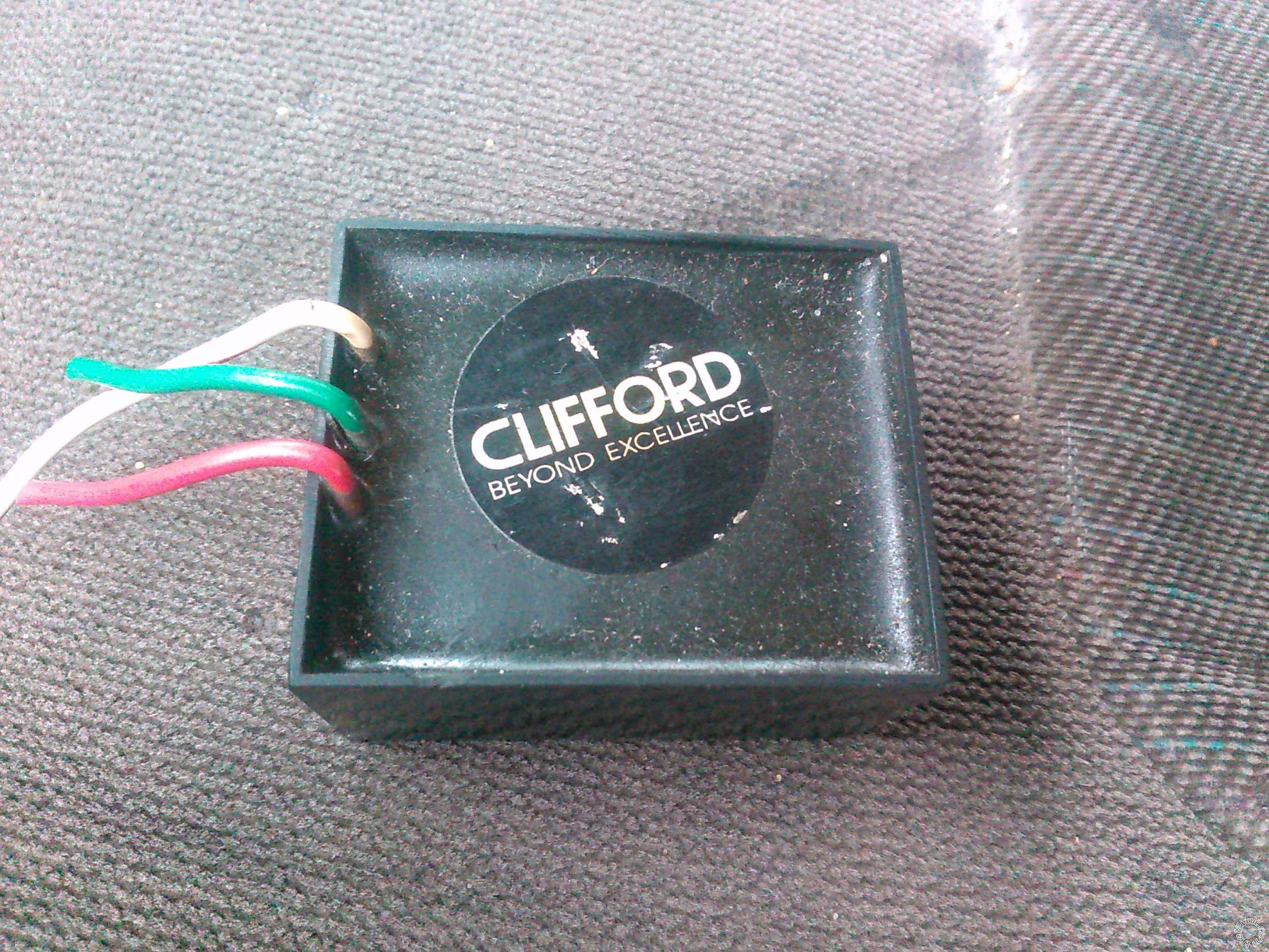

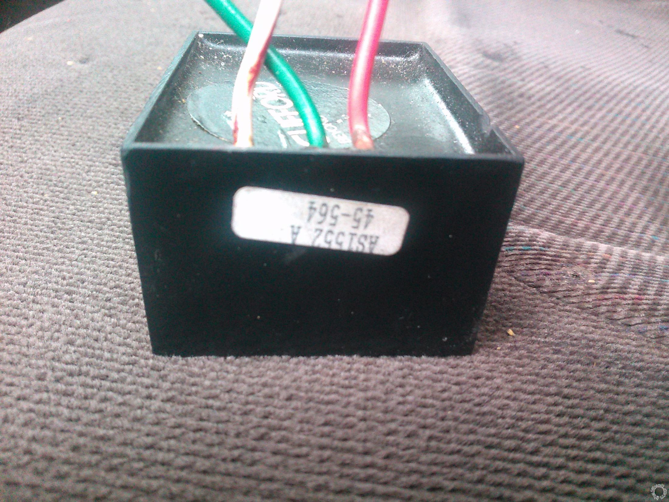

I have no idea what this is and Clifford has been no help at all. Can it be bypassed and can I get a new one? I think it may be responsible for a battery drain issue.
     What Is This Clifford Unit? -- posted image.

Perhaps some kind of fuel cut-off relay? I’ve never seen one before but maybe an older variant of the
Clifford 50-841

What was it hooked up to? Where did the wires go in the car?
A Starter Interrupt can be done with three wires.

I really dont know where the wires go. There are allot of buried wires for this alarm and clifford has been no help with wiring diagrams. So far I only know that the battery stopped draining when I cut this out, but the alarm stopped working as well.

OK, the red and white wire went to a fuse which taps into one of the main power wires. The red wire goes to a fuse which taps into the other main power power wire. The green one goes to a connection point (which I also think is power but could be ground) with a variety of other wires.

Not from '85, more like '95 and its not a 6000, its a Intelligaurd 600 and for the life of me I cant find a wiring diagram. It also has something called a "sense and tell" installed.
